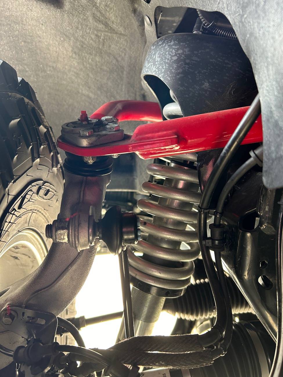

I went with JBAs because the bushings and BJs are both greasable and the BJs can be replaced without a press and on the truck. I have 35x11.50 tires on stock wheels and needed 1/2” spacers and extended thread lug nuts to keep my tires from kissing the front of the UCAs at full lock.
