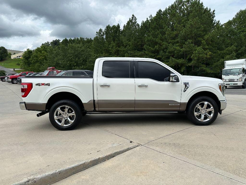

Just purchased a 2023 King Ranch with the 3.5 Powerboost motor. Its a standard 4x4, so no FX4 package. I do not believe it has the CCD system. I am looking for the best way to get a 2-2.5" out of the front. Best way meaning not too much strain on the front end control arms, and a kit that will not cause any issues with the electric motor and high voltage cable locations. What are you guys doing for these trucks? I have heard that some people put the Fox 2.0 ('15-'20) kit on their truck because of the heavier springs, but I do not know what this is about.
I have been looking at the Bilstein 6112 stage 1 kit on stage3motorsports as well. Will this kit suffice? The local guys in my area aren't too well versed on the best way to level these powerboosts, as I guess its not too common. What are you powerboost guys doing to achieve this?
