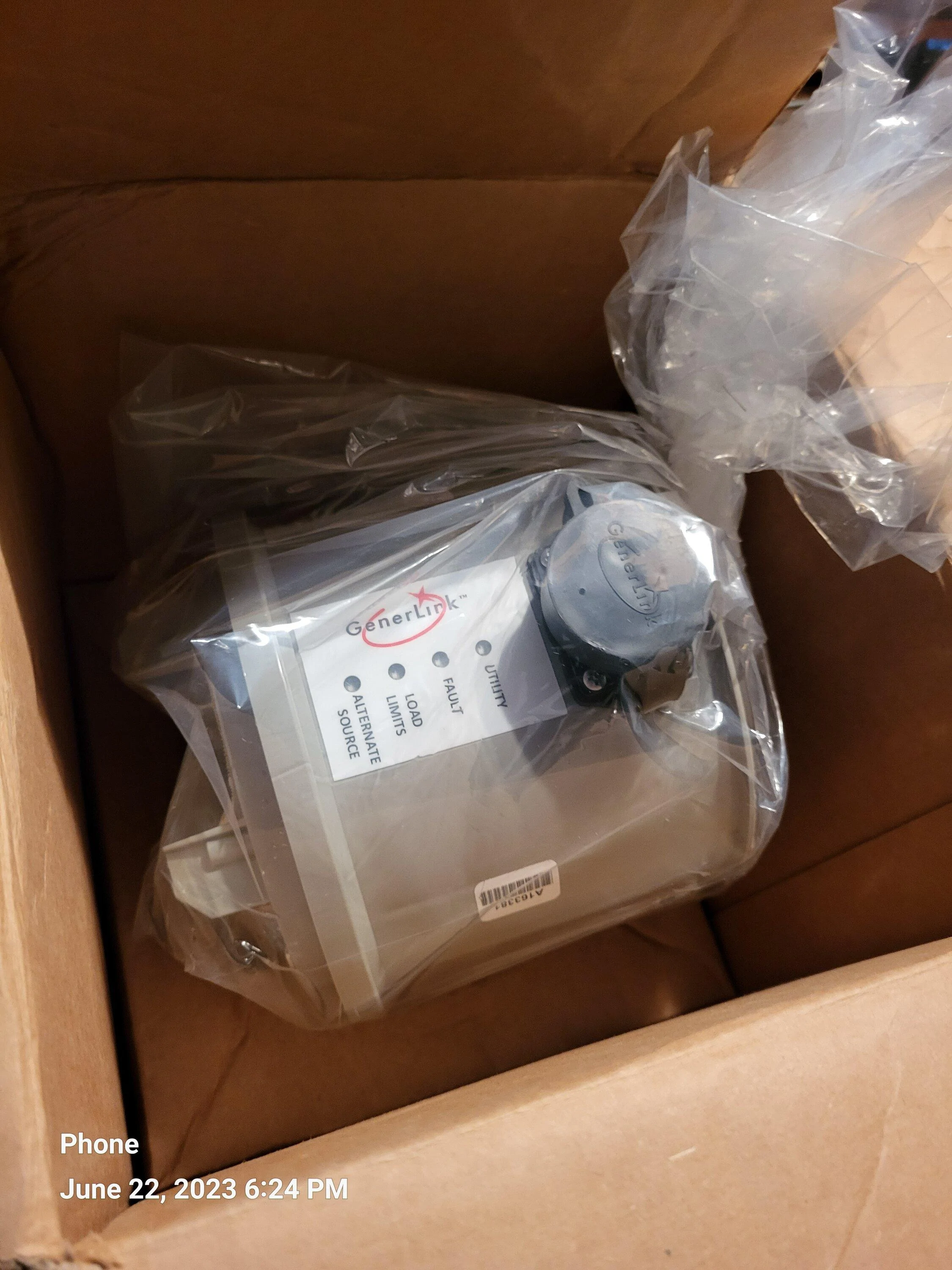

a few years ago my power provider which is a COOP turned me on the generlink system which a transfer switch mounted at the meter base under your power meter. it allows you through a proprietary cord set to plug in a generator up to 12,500 watts surge and 10k watts continuous or 40 amps
it will run an ac and any other needed stuff like fridge or freezer etc

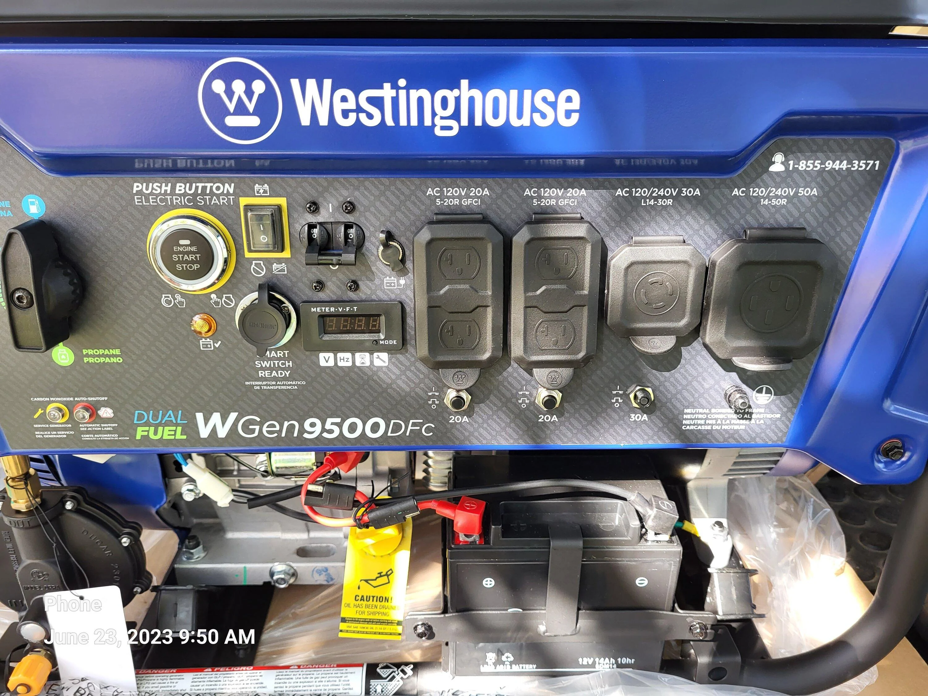

last week i decided enough and ordered a new portable 12,500 peak and 9500 continuous genny and generlink
toady power company installed my generlink and i now we are set
generlink is not cheap 40 amp with surge is 1k bucks and so was genny as i got it on sale plus vet discount and it was not made in china...it was made in veitnam
most power companies in the hurricane zones allow this unit
you just need to call the generlink folks and they can tell you if your provider is a carrier or not. some power companies even have the device you buy from them vice a distributor. i got mine from gainesville georgia s he had them in stock
Ford F-150 generlink transfer switch up to 40 amps 240 volts 20230622_182816
Ford F-150 generlink transfer switch up to 40 amps 240 volts 20230622_182430
Ford F-150 generlink transfer switch up to 40 amps 240 volts 20230623_095057
Ford F-150 generlink transfer switch up to 40 amps 240 volts 20230622_182447
Ford F-150 generlink transfer switch up to 40 amps 240 volts 20230623_103445
Ford F-150 generlink transfer switch up to 40 amps 240 volts 20230623_094254

YUP
A different transfer switch for pb is a must
thus one is limited to 40 amps
but that will run most of my place in emergency
ac, internet, lights and freezers, sump pump etc
whats good here, is the electric company has given its blessing so they do the install and of course check the circuitry and fix or adjust any ground issues or the like
i still have to to do a run in load check within 3 days to ensure warranty is in place
it also has a huge white appliance coverage for surge as part of the generlink
i can plug in genny and it will turn off line power and then use genny to run house.
for us it was very cost effective versus the generac standby thing since we dont have nat gas and would require a HUGE propane tank and separate electrician to do the install while the electric company watches
