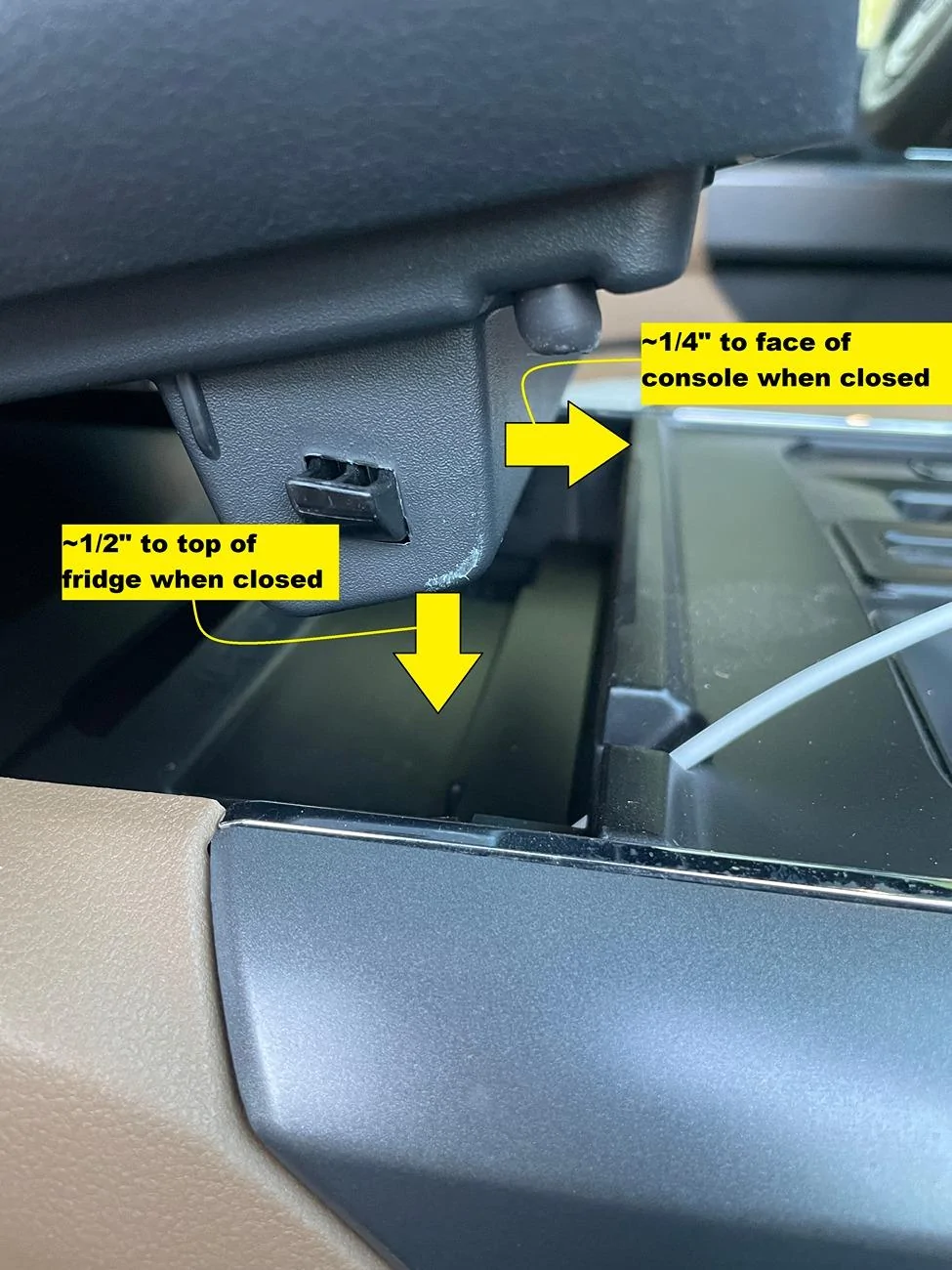

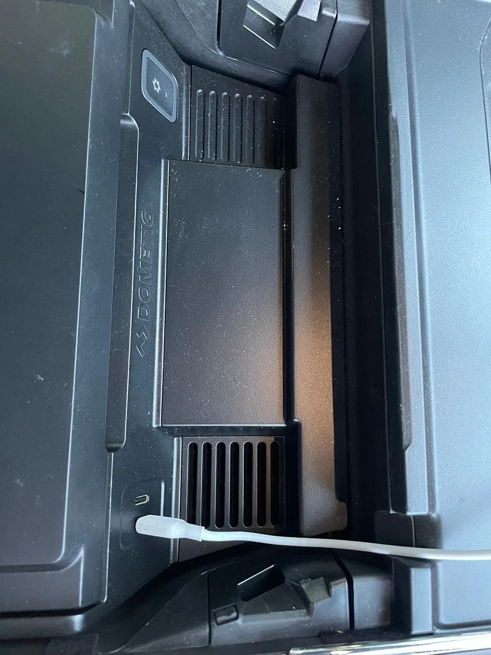

do you know the clearance height from the fridge and the USB ports? I'm interested in doing this but would like to use something like this to relocate them to the driver side panel (near the fridge power switch)
I'm not sure I understand your proposal, but FYI / FWIW this pic is from my 2022 Lariat with the Dometic Console Fridge. Your console lid may differ (?) but perhaps this is of help?
Ford F-150 Gen 14 F150 Dometic Console Refrigerator IMG_2399
As seen below, I use the provided USB port with a shorty-cable to charge my Iphone mini, residing on its side in the slot next to my shifter. I'm still loving my Dometic Fridge, thanks to Rineland!
