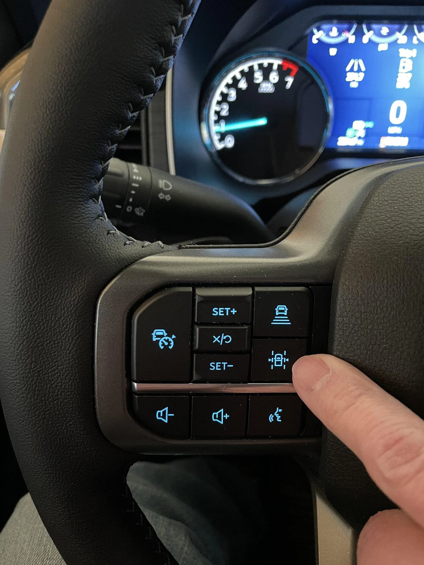

The button on the left side of the steering wheel will switch it off.

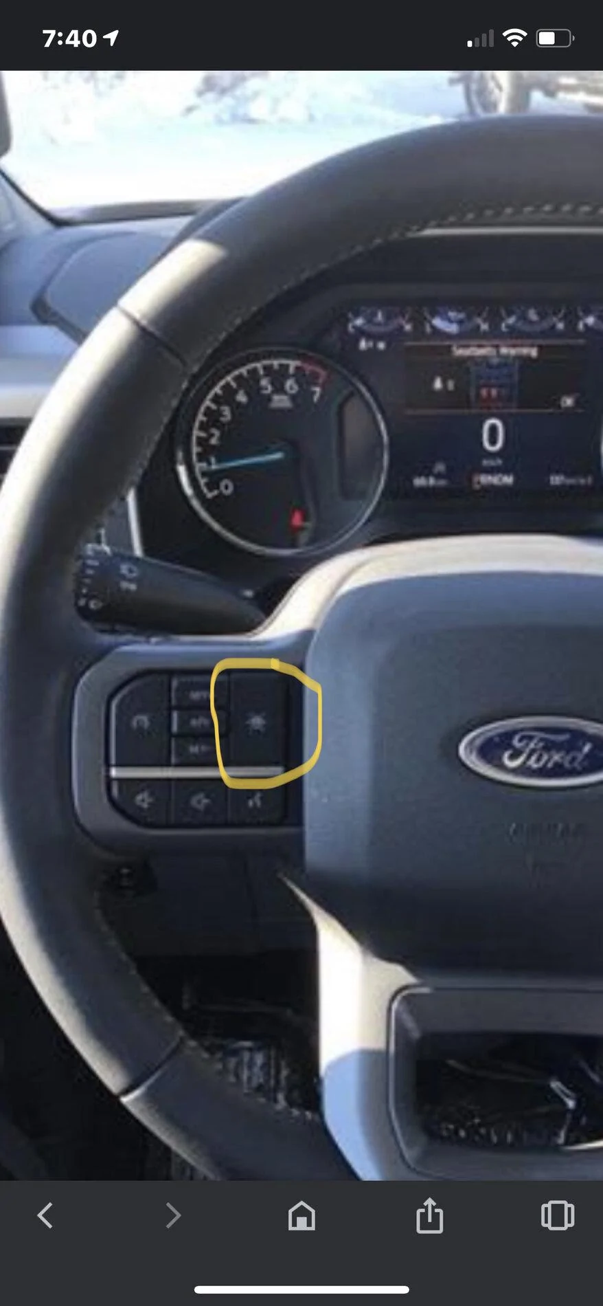

Here’s a more specific picture from my own XLT.
I tried that button and it did not change. Don’t know what to think now. Is there a setting in the center screen?

That’s odd that there was no change when you depress the steering wheel button. This is what it should do when you press it;

I figured it out. You have to turn off distance indication under features then driver assistant on the big screen.
thanks for the help and time
