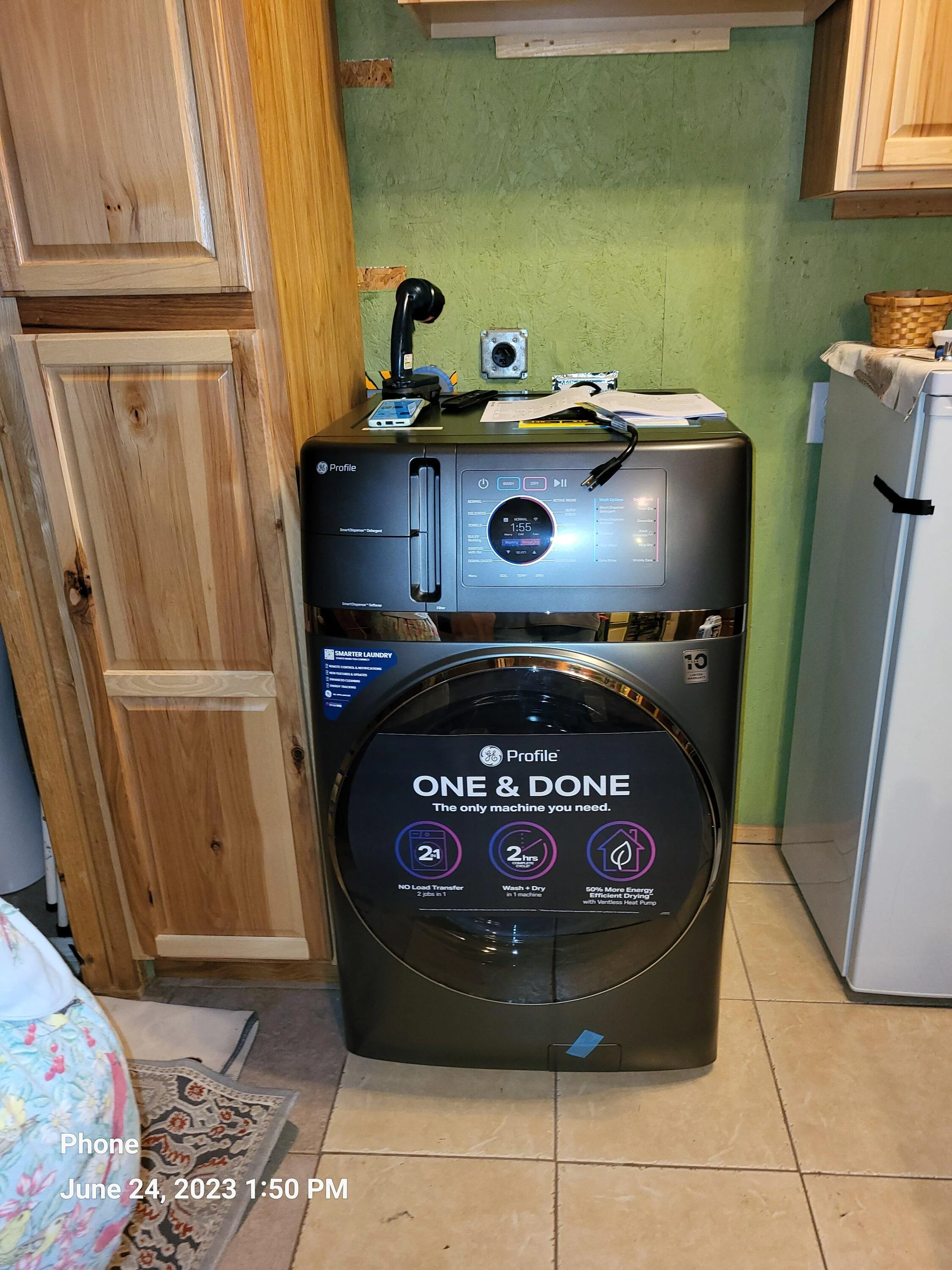

I could not pass up the deal, plus we are always looking to save space in the big house (1000 sq feet) so this little gal was a perfect fit
we have an all in one in the bus, but it uses a weird cold water spray to produce heat to dry clothes and takes a while
this girl is actually so far 7 to 10 minutes faster than washing , then taking clothes out and putting in a dryer, plus it only uses 120 volts vice one circuit of 120 for a washer and 220 for the dryer
heat pump dryers are not NEW, but they are not very old HERE in the U.S.
long term i hope this one lasts as long as my other front load machines
its quiet as a church mouse, only puts out a small amount of heat compared to the big electric dryer
and i gained some new cabinet space
