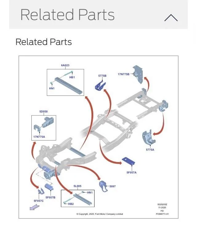

Just FYI, attached is the Workshop Manual procedure for replacement of various lengths of the front frame section on a Gen 14 non-powerboost. The Manual provides no procedure for repair or replacement of only the LCA mounts.
Based on that and the OP's pics IMO the insurance company is not looking for an "approach which is meant to save them money", they're looking at the Ford recommended repair procedure for the damage at hand (and far from inexpensive by the time all is said and done).
Personally, I'd be thankful for that rather than have the insurance push for 'cost-saving' attempts to 'straighten or repair' the LCA mounts in-situ.
