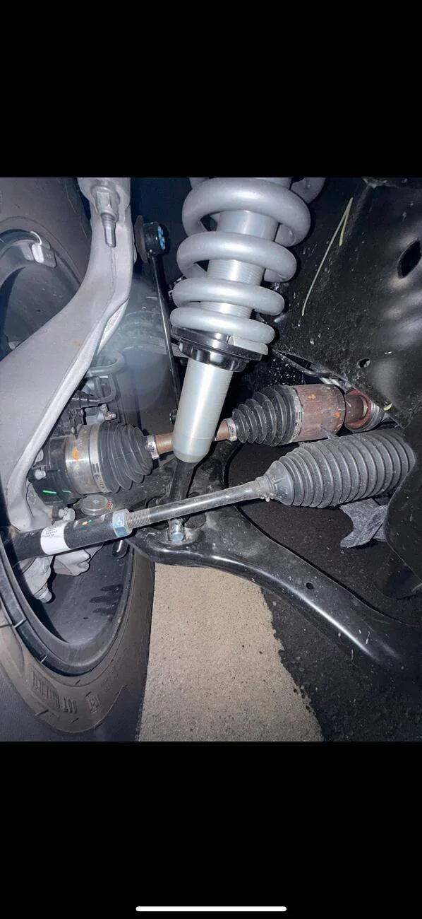

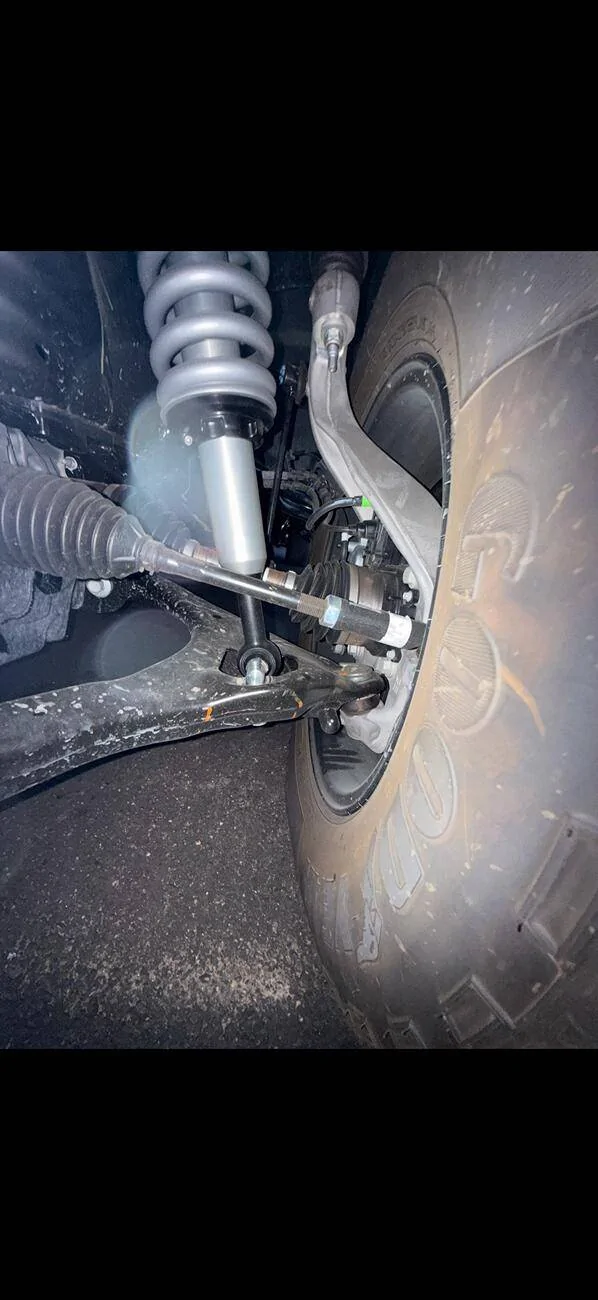

A picture is worth a thousand words. Post a couple to show how much lift you dialed in, CV angle, and what your coil to UCA clearance is.
Pictures under this

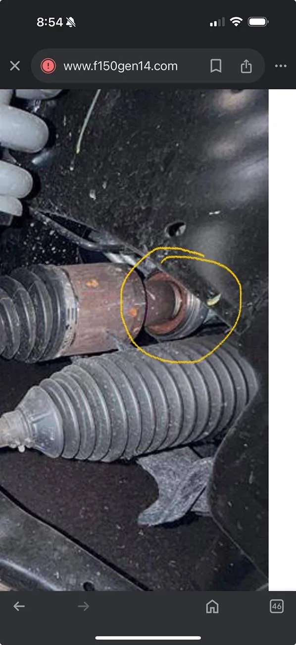

It looks like your inner CV splines needs to be seated into the differential.
i see now. Idk how I missed that. I’d have to take everything off to be able to seat it all the way?
You might get lucky and be able to pop it back in without removing anything. It’s worth a shot.
Just tore it back apart and the CVaxles all the way in. I retorqued the nut just to double check. Still making the noise. It just sounds like binding either I’m going straight or turning it does it.
