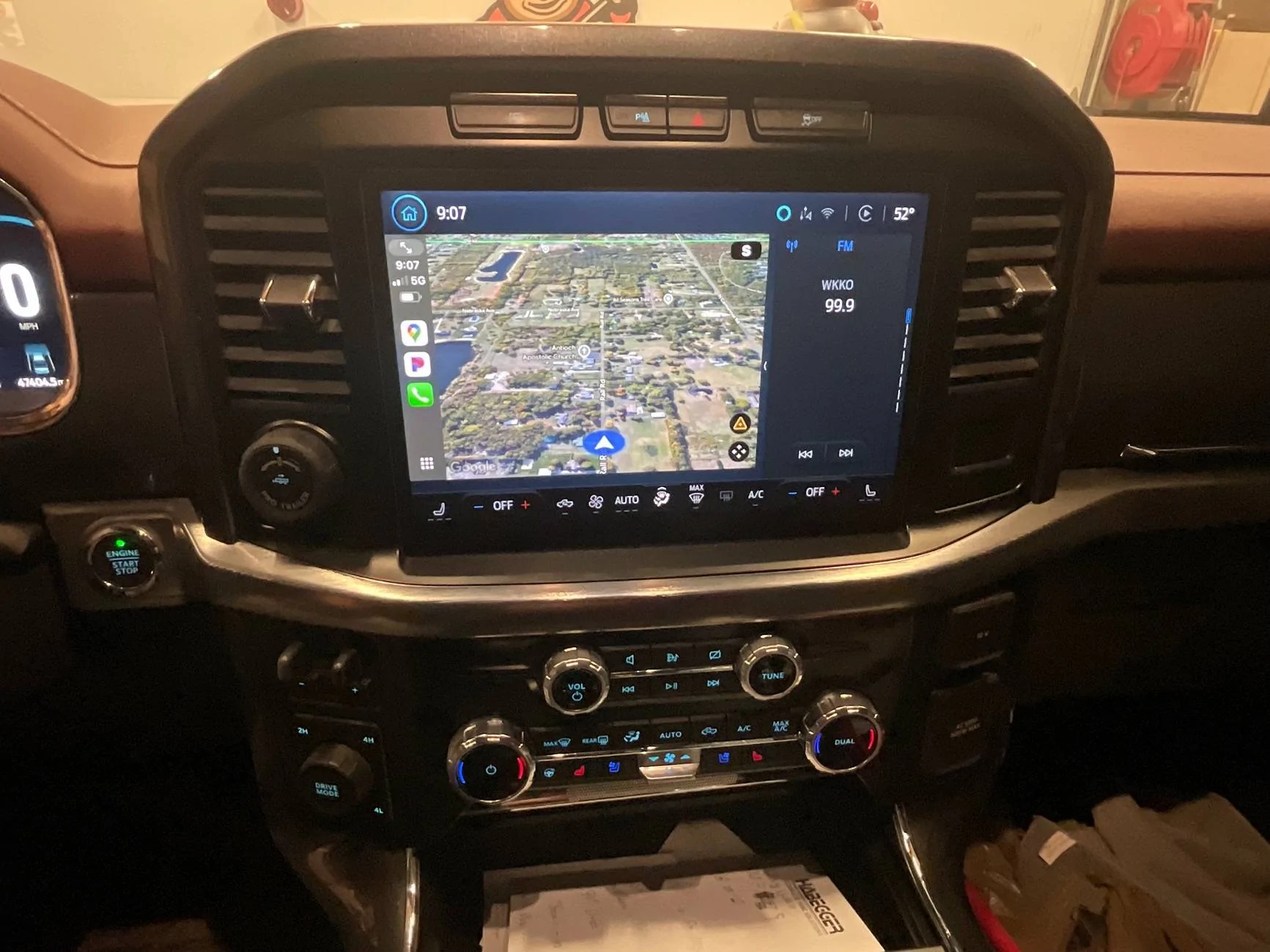

Got forscan And did a bunch of mods And am satisfied with them.
Tonight I went to do some more mode in the apim And didn't like the outcome so I went to restore the file and it keeps giving me an error that it can't read so it won't restore original entries.
I even tried factory load and still no help.
Does anyone have original data #'s for the mods I did.
Ive attached a pic of the mode.
I added hvac controls to my screen but don't like them so I want to go back to original setup.

Take a picture of your screen with the HVAC controls on it. I would like to see what it looks like. I want to do that to my 2025, but would like to see the screen first. You can search as built data information, and download all the original values and save it. You will need your vin to get the correct info. I will try to look around where I found the as built data.

@swpm9073 , I can do what you ask, but I need you to give me your current values for those items.

Here's a pic of after mode were done
Heya,
This is what I found.
Got my original build from the site and re did my #'s and it worked

@swpm9073 Warren:
7D0-02-01 xxxx 42xx xx-- the "4" you're leaving this one as is.
7D0-02-02 xxx0 xxxx xx--
7D0-02-03 xxxx xxx0 xx--
Then reboot the APIM in service procedures (the spanner icon).
