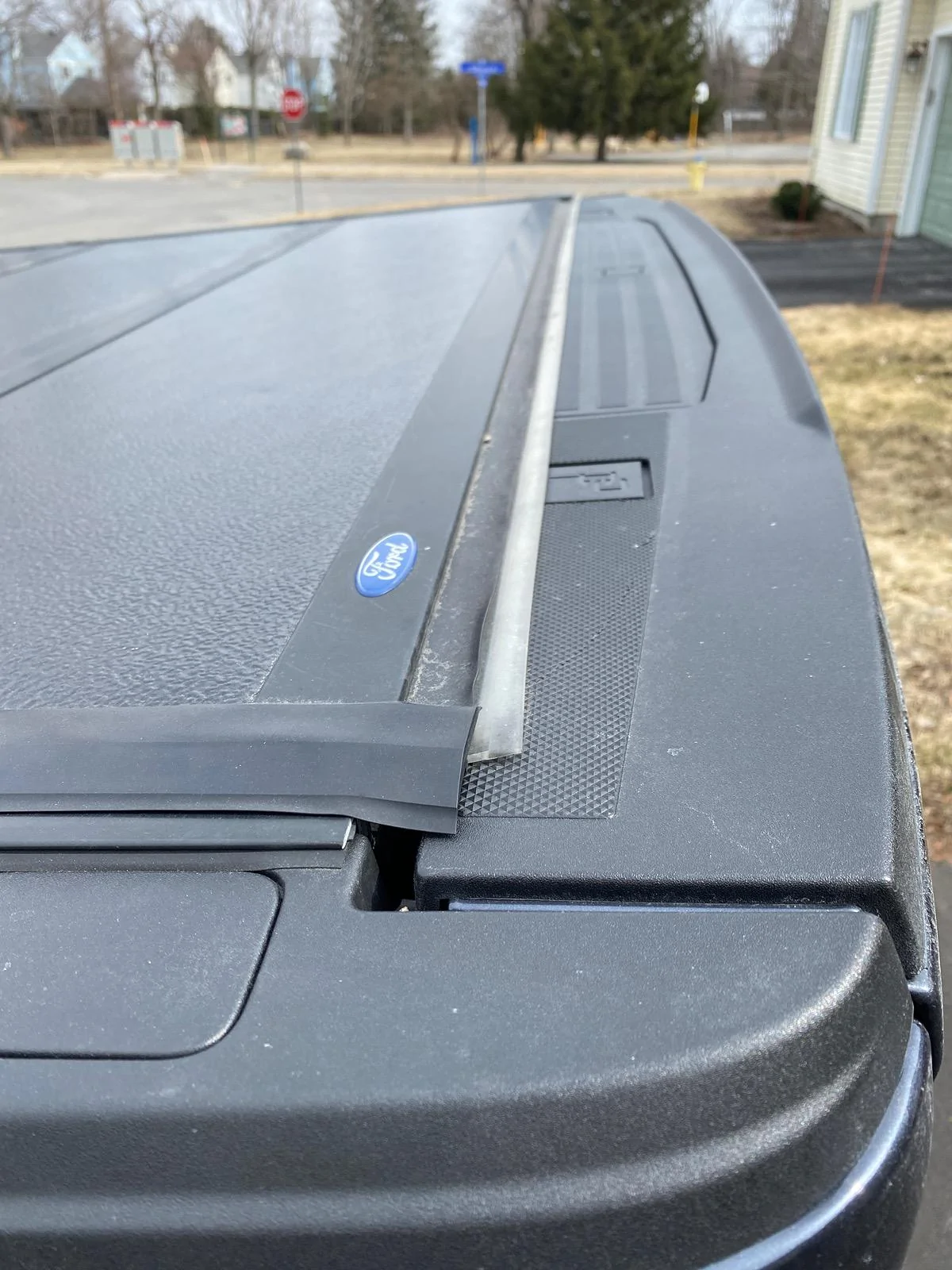

Worked this hard tri-fold tonneau cover into the deal on my truck. Not quite as low profile as I would have liked but the pics on the Ford website make it tough. At least the cover seems heavy duty and super durable. I’ll provide an update after the first heavy rain to see how weatherproof it is.

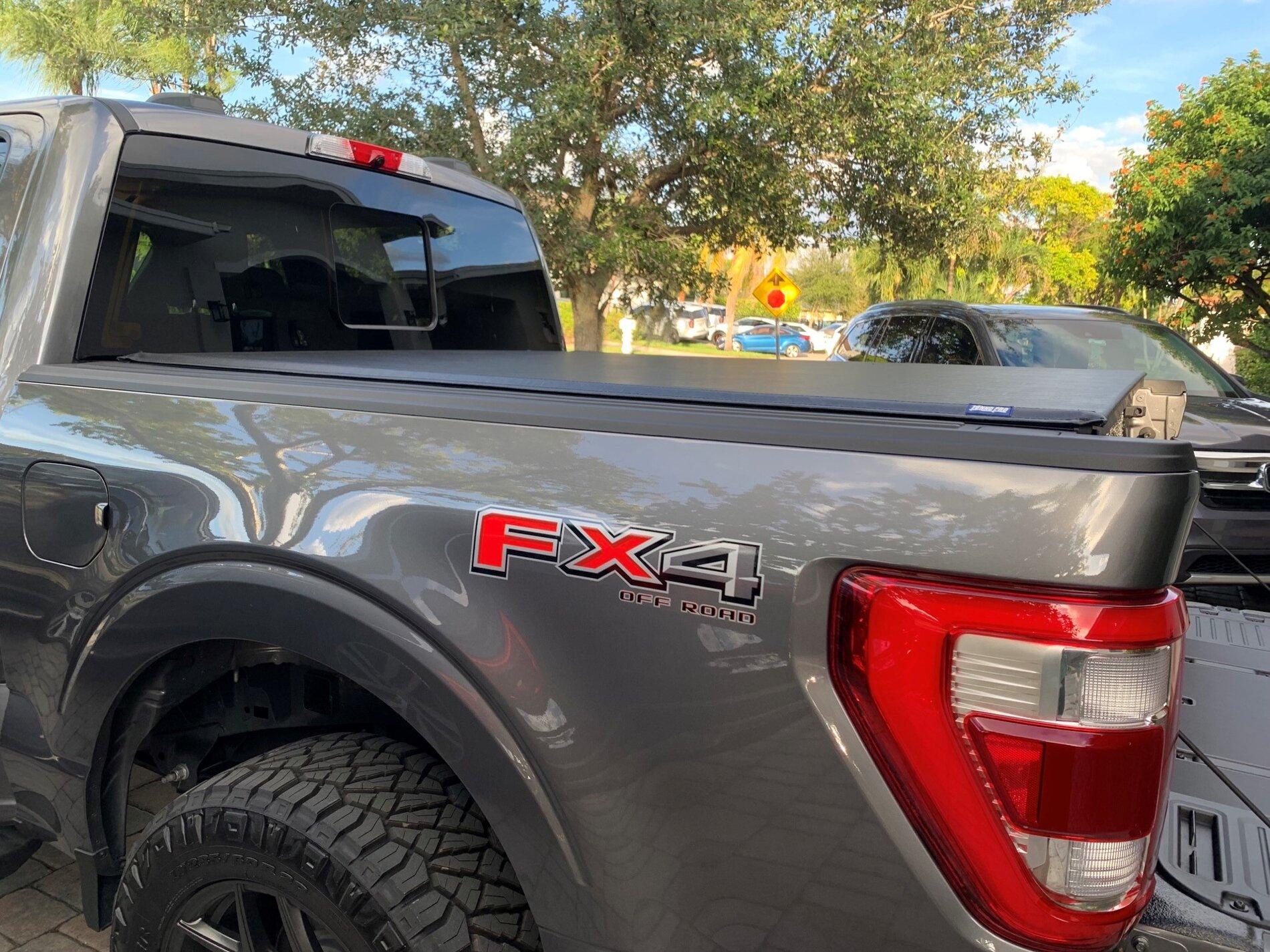

I went with Tonno Pro. Not bad for $250, it's lightweight and with life time warranty.
I really don't store anything valuable in the back so not worried about someone trying to cut the the cover open.

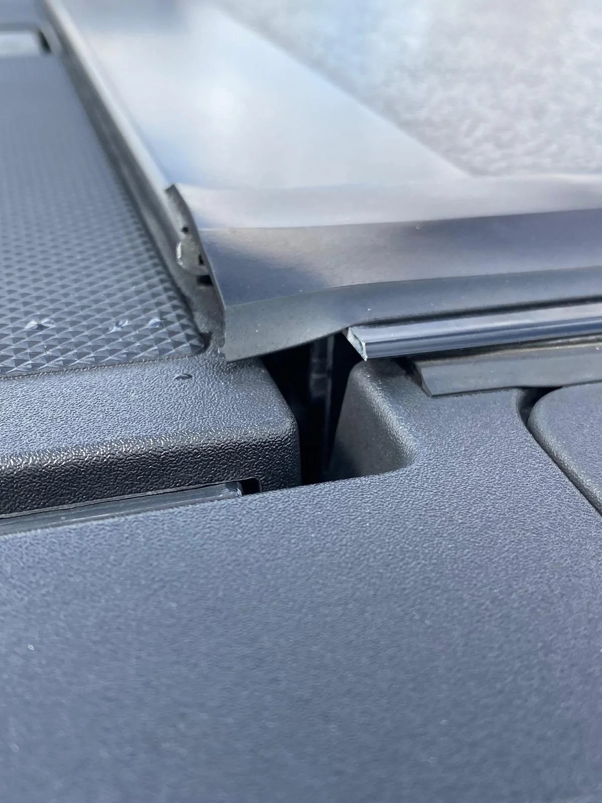

My ‘22 PB Limited had a Fors Tri fold hard cover in it and leaks like crazy at the tailgate .. large Gaps at the corners . Any help ???

Here are a couple pics of the corners at the tailgate .. any suggestions?

Are you sure it's installed correctly? It looks like it should be forward a little so that the end of the cover is flush with the tailgate, not above it. Mine is a Revolver rolling style that lies lower on the bedrail than this one.

Dealer installed I think , it was on it when I bought it . Would it be possible to move it back and reinstall
That would not help keep water out .. I’m pretty sure ..

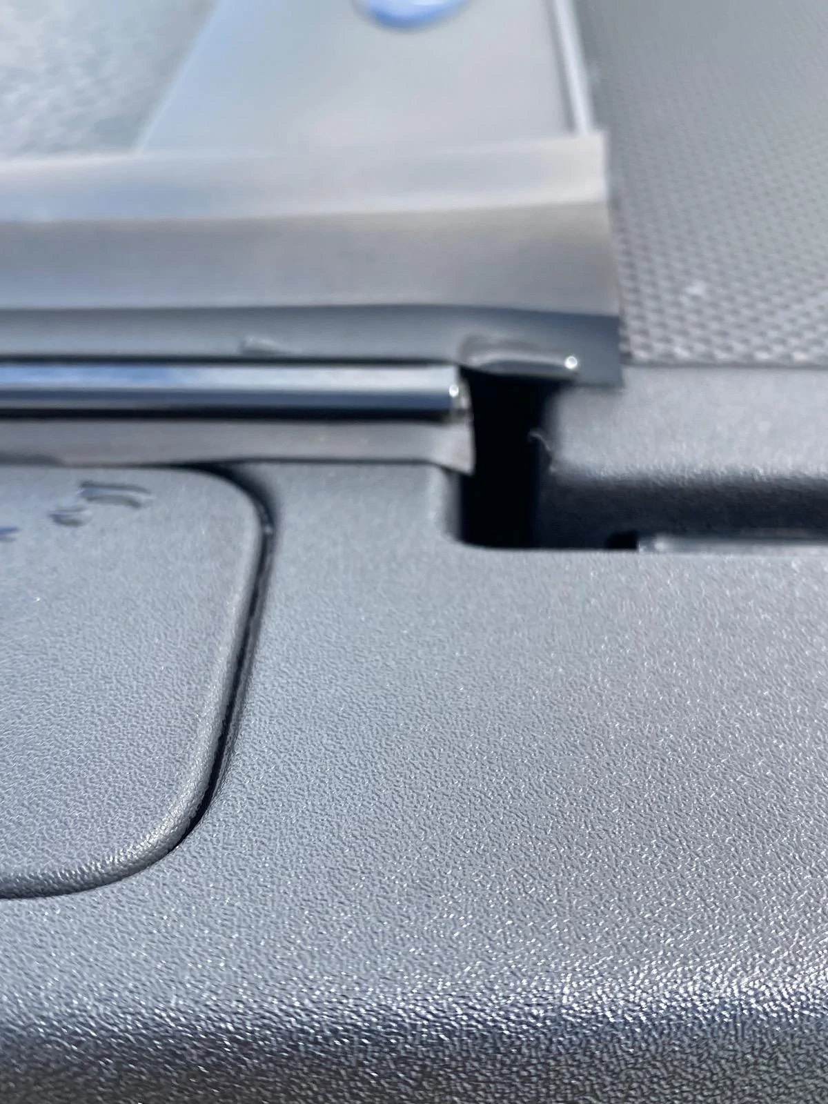

Yup. That would compound the issue . Dealer installed mine a little too far forward, added the clear weather stripping and it helps somewhat. A box dust sealer kit also works but it’s not great at the top where the tailgate meets the sides. There is a lot of rubbing each time the gate opens and closes
