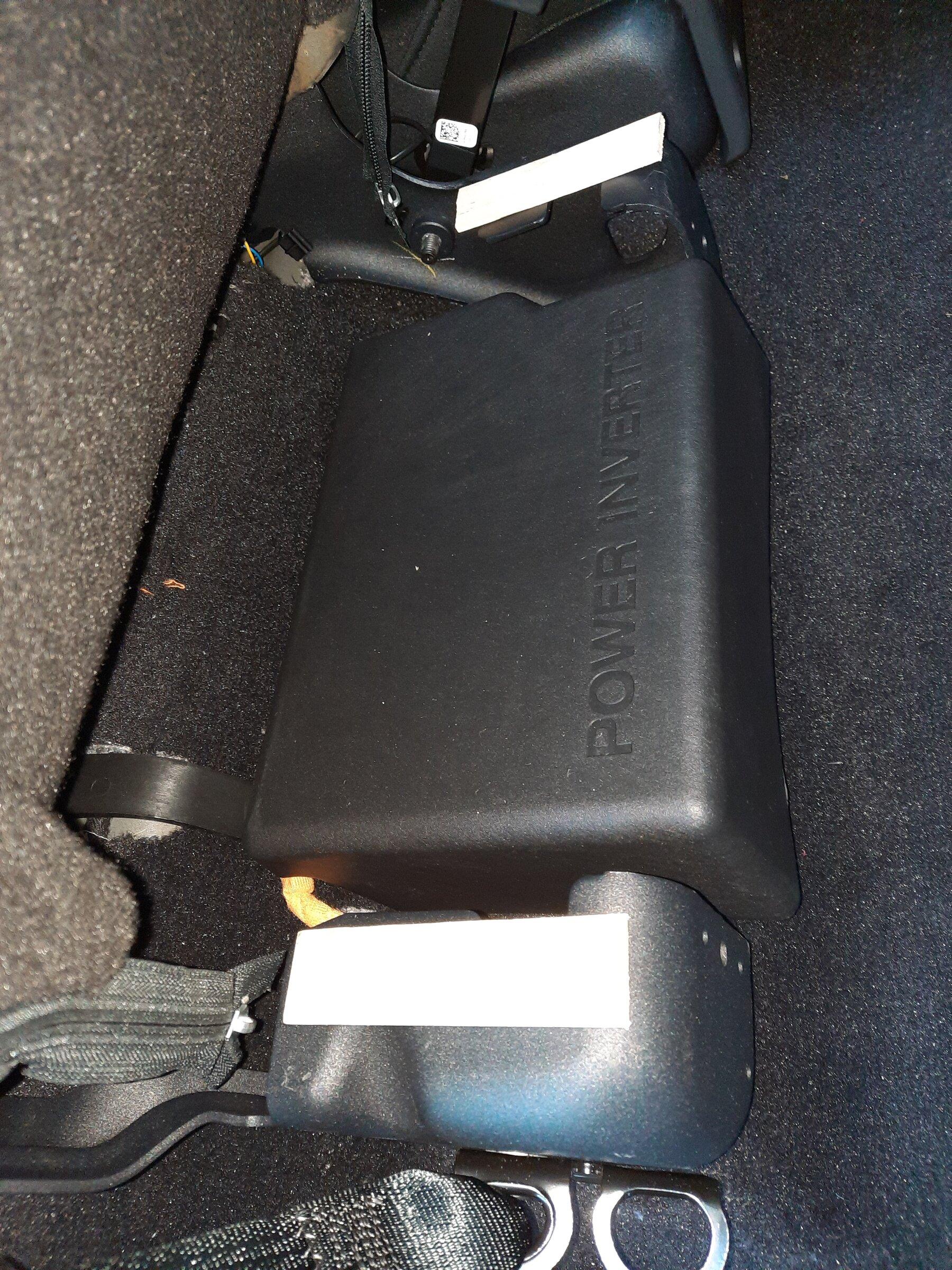

I got my new F150 and the back seats had a height difference of almost 2 inches. When I talked to my dealer they looked at several trucks on the lot and many of them has the same issue and it looks like nothing will be done about it. Here is what I did to fix the problem which only took about 1/2 hour and $4.

  5. In the fifth photo, you can see that I have attached my spacers to the metal on the bottom of the seat. After this I closed the zippers and lowered the seat.

The seats are perfect now and I am happy with the results. Hope this helps anyone looking to level the back seat.

Ford F-150 Fixing an uneven back seat 5-spacer on bottom of seat
