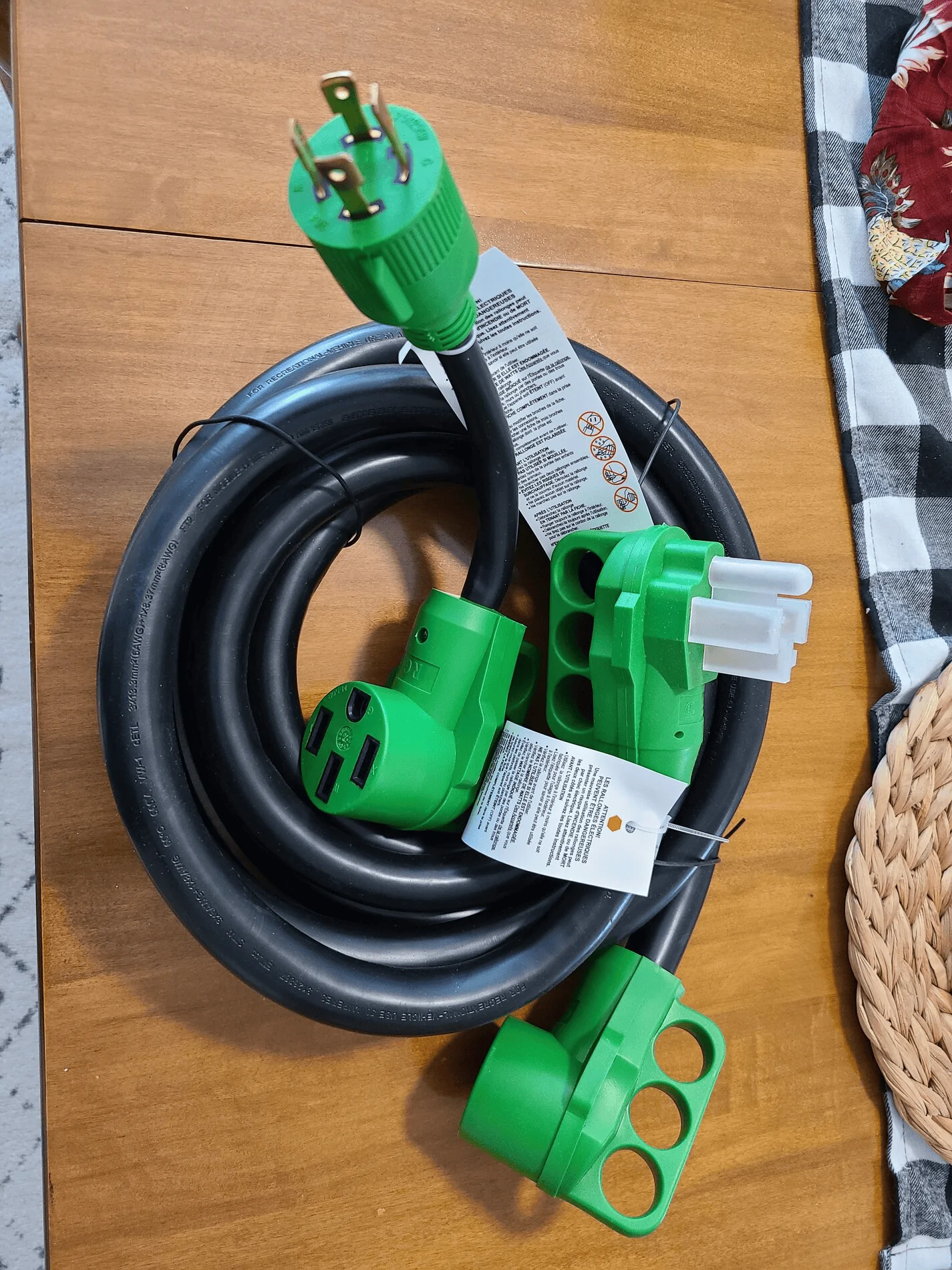

This is supposed to plug into my truck that is still sitting on its a$$ in Dearborn for no apparent reason. I can't wait to get this thing hooked up and experiment with the appliances and determining wattage and which circuit each AC is wired to. Plus what the thresholds are for kicking the engine on vs silent (battery) operation, etc.
The picture is a simple 12" dogbone connector (to give better strain relief than a solid adapter). It converts from the truck's 30A plug to the standard 50A trailer plug. Then I got a 15' extension cord. 10' is probably enough but I got 15' just in case. I have to go from the rear of my trailer (32' hitch to bumper) and the default cord is 30'. I also have a 50A surge guard that is about 18". My plan is to go, starting at the truck: dogbone, 15' extension, 18" surge guard, 30' shore power cord. This is 47.5' total length to go up and over the tailgate, down to the ground, and back up to the shore connector without too much strain.

@daemonic3 , what brand/source is the cable and dogbone you have? It looks far more flexible and manageable than the Camco ones i've seen online.

Yep! They are RVGuard from Amazon. Everything from etrailer and amazon seemed comparable so I picked them because I liked the bright green color and LED. They sent the cord with a cool re-useable bag with RV's all over it.
