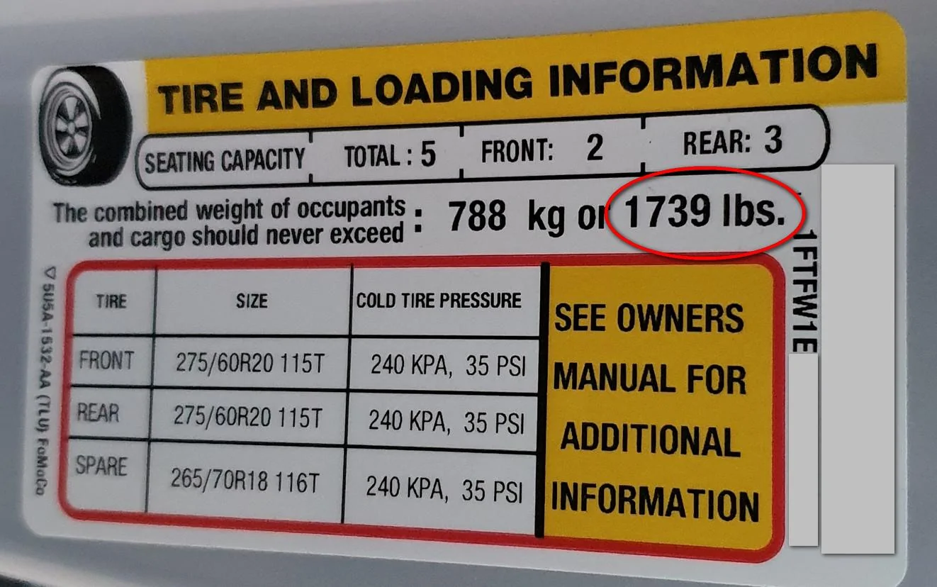

This puts my loading capacity at 1613 lbs, which is about 126 lbs lower than my max load rating:
Ford F-150 First time ever on a Cat Scale with SCREW 5.0L Loading info
I assume the Tonneau cover is roughly 60 lbs, that leaves me with additional ~60 lbs that are somewhere on the truck, unless I am reading these numbers incorrectly.

Ford does (kinda) provide as built curb weight (with some math).
Take your GVWR from the other door sticker and subtract the Payload from the Yellow Sticker. This is your As Built Curb Weight, as Ford understands it. As Built Curb Weight only includes all options installed by Ford at the Manufacturing Plant plus all fluids (coolant, oil, full fuel).
Does NOT include any Dealer (or Customer) installed options.

Which brings me to the same 126 lbs difference:
GVWR = 7050
Payload = 1739
"Official" Curb Weight - 5311 lbs
Actual Curb Weight based on Cat Scale and itemized weight - 5437 lbs.
The Difference is 126 lbs, however my actual Cat Scale weight includes the Extand Tonneau cover.

Yep, that and the fact CAT scales are (at least) +/- 20lbs accuracy.
I knew from your post you had it all figured out. I was just replying for others, who wanted to know what their As Built Curb Weight is without finding a CAT scale.
