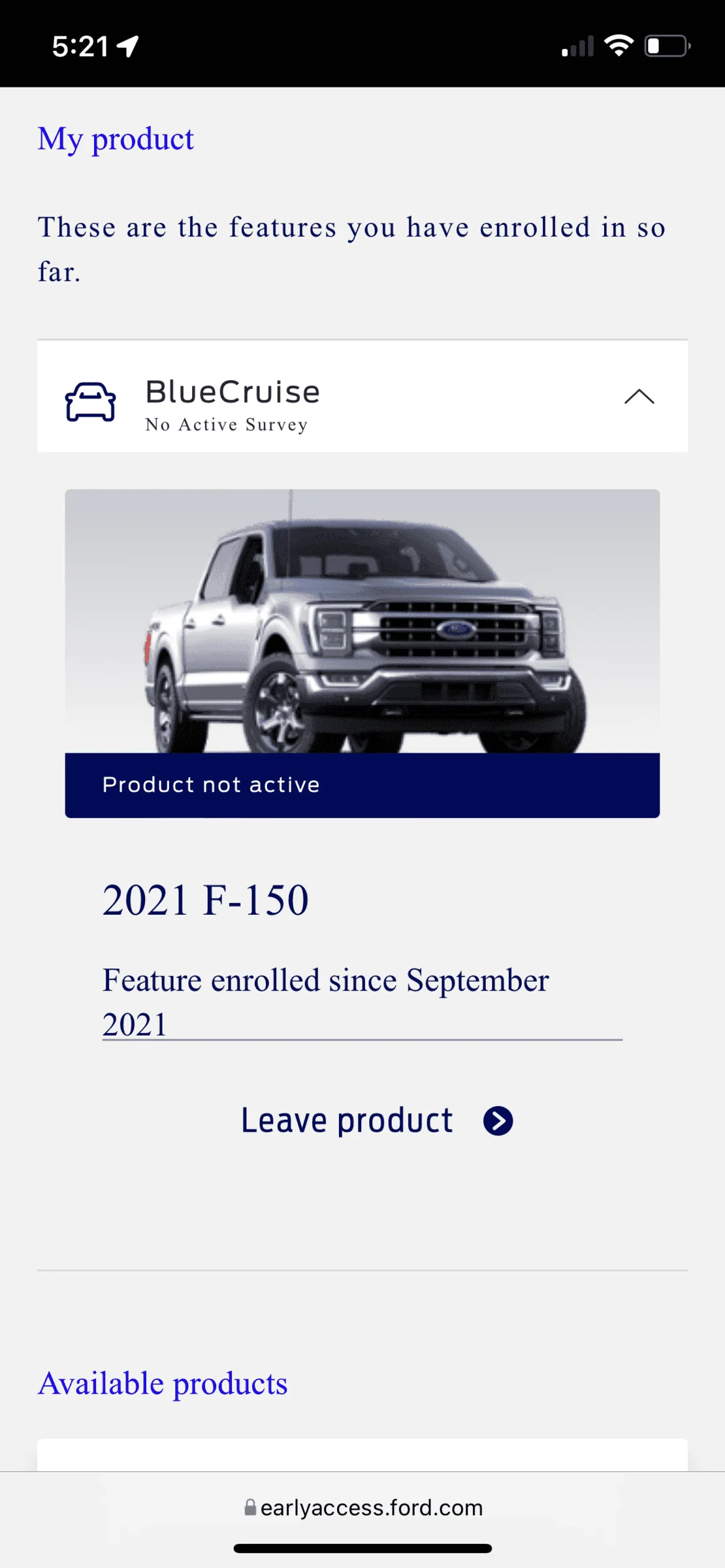

Ok, I was just curious. Not sure what to suggest. Have you confirmed the subscription is in your connected services?
It is not listed in connected services. My early access has it list but says product not active. I guess Ford has to turn something on.

Ok looks like its not active on Fords end as of yet. But I can see that the modules have been updated to the appropriate software. So its a waiting game still. Im am guessing as soon as the connected service goes active it will work for those that have had the 2.5.1 update.
