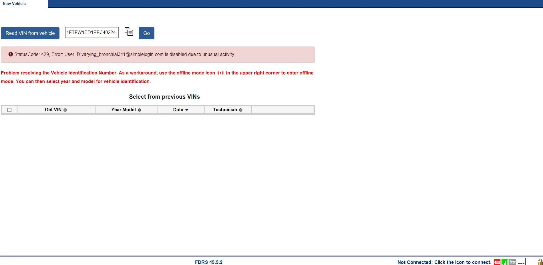

evert time i create an account it gets banned i use nord vpn and same problem can anyone help please

If your truck has been recorded by a dealer as located in your country, or if your truck has been authorised in fordpass with a ford account created on a Ford web site outside of North America, it is very likely that the ford servers know your geographic location is non-USA/CA and therefore it doesn't allow you to use FDRS (Which is for North America use only according to the licence agreement).
I use expressVPN which you could try. Make sure to connect to a North American vpn server. Also, when you buy your licence from Helm Inc., your address needs to resolve to a physical address located in North America.

thanks a lot for your help i am in middle east

I know there are issues right now with accessing FDRS from Middle East. VPN won’t cut it. Ford is locking down heavily on this side of the world.

thanks for your reply. is there a wat to open it?
