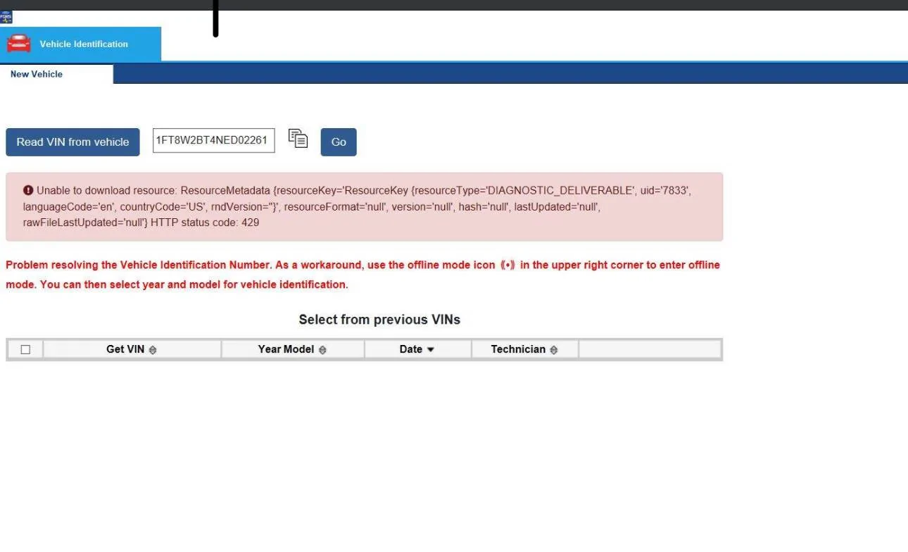

Sorry to re open an old thread but I’m having some major dramas with VPNs and FDRS ( Because I reside out of the USA)
I’m trying to update my 22 f250
All my attempts end with locking the account by ford, I’ve created about 6 accounts and the furtherest ive gotten is this error then locked account
Any help would be greatly appreciated
( currently using the express vpn, have tried shark, unless I’m missing a setup step for these vpns)
Ford F-150 FDRS LOG IN Huge Problem Need Help Please IMG_2544

Ford has majorly cracked down on these things. I have had a few people tell me that even using a VPN, their accounts still get banned. I am not sure if there is a way around this anymore, but if you do find a way, let us know for future reference.

If a truck has ever had its VIN associated (authorised) with a non-us FordPass "garage", the servers must have a record of that. So, when the VIN is checked in FDRS, and it comes up associated with a non-US/CA fordpass account, I believe that is what locks out the truck, regardless of what accounts are created. The selling dealer (non-US/CA) may have somehow done the association in some other system; I don't know. This seems to me to be what's happening.
I used to be keen on getting a TCU that works here because I can't authorise my truck as that process requires cell network connectivity. Therefore, for me, fordpass will not work. As far as ford is concerned, therefore my truck has never left the USA. I no longer wish for a local TCU ?‍♂?
