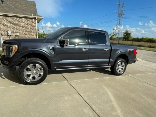

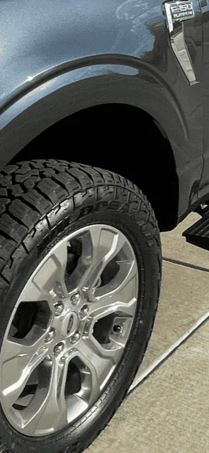

I know that this thread is kinda old, but I am running this setup. I went with the Wildpeaks as I had narrowed my choices down to four: KO2s, Toyo OC AT3s. Nitto Ridge Grapplers and the Falkens. I decided to stick with the 275, 60, r20 size because I was worried about raising the truck more and affecting Bluecruise (already did the 2" ReadyLift level). Also, wanted an SL tire as opposed to an E load tire. That basically took out the KO2s as they are still a good deal heavier at this size. The others are all in the 45 lb range (similar to the Hankook stockies). After doing my research, I eliminated the Nittos as the hybrid pattern is just not as smooth as the Toyo or the Falken. I went with the Wildpeaks at that point because of a sale at 4WP. They turned out fine. I would prefer them in 34"s, but that would have been an E Load. On 33"s they quite honestly ride better than the stock Hankooks and there is zero fuel economy hit. None. I just ran a 300 mile test, and I got 20.1 mpg in my normal driving and I average 19.1. I assume some of that is I was more conscious of my driving, but still, I am ready to proclaim that these babies are smooth and efficient. I think they look way better than the worthless HT look to the Hankook.
