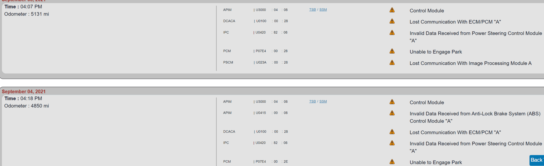

Hi Vulnox, sorry I missed this reply. I believe it may be something with the GSM and it’s communication with the shifter and other components in the truck. Definitely a digital problem possibly caused by a mechanical problem within the shifter assembly. Speculation at this point. For example, while the shifter was stuck in D and blinking, the truck thought it was in P as indicated on the cluster. Very odd. A mismatch if you will. There is a TSB out for it and the TSB states to replace the shifter assembly and reprogram the GSM. Ultimately me messing with it physically broke it as it’s a fragile stalk of plastic, I certainly didn’t mean to snap the stalk but it happened. It’s just crazy that it interlocks erroneously into a gear position like that, clearly resulting in oafs like myself accidentally breaking the plastic lever….. When it snapped, it revealed a ribbon cable that runs from the assembly up into the handle. Probably for the manual +\- shift buttons and the button on the back for moving gears.
There we’re definitely faults detected when I scanned with Forscan. My VIN is below if you are able to pull them from Oasis that would be awesome.
1FTFW1CDXMFB86257

Thanks! While it shows the code, and different code each time, there doesn't appear to be an immediate TSB associated with the specific codes logged. Some of the other codes you can ignore, I have them as well. I think some are triggered from the truck startup and are just caused by low power conditions when starting. The Control Module has a TSB but is related to getting a message about power steering at startup, again not related to the park. Wish I could help move it along by giving you an SSM or TSB.
Ford F-150 Failed Console Gear Shift Lever 1630959341924
no worries! Thank you for checking! Interesting to see info from the other side. I think the battery drained while in Emergency Neutral. It shows offline now in FordPass. That may be what the low power state was.
