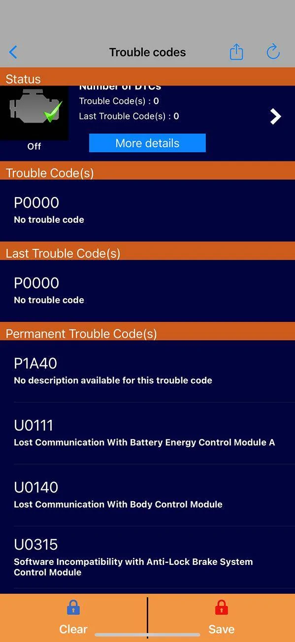

Hello everyone, I need some help with my F150, can someone explain which errors does not allow to crank up the car. Or some info about all errors I have. I have a blinking green on my start/stop button. Thanks for any help !
Ford F-150 F150 Powerboost 2021 does not start, have some errors IMG_1594
Ford F-150 F150 Powerboost 2021 does not start, have some errors IMG_1595
Ford F-150 F150 Powerboost 2021 does not start, have some errors IMG_1596
Replace the batteries, always looks like catastrophic failure of everything. U can go to sams club, costoco or bjs and get batteries at a fair price. Only made to last 3yrs for any manufacturer. Good luck.

Have you checked your 12v battery? Recently had some odd codes and they seemed to be related to low battery charge. Got the battery charged and so far haven’t had any problems.

Unfortunately, problem is not with batteries, car doesn’t see a hybrid system. I do not know why. My previous thread was about this, BECM has another vin number, but all other modules have a proper bin number.
I still say the 12v in the engine bay and under the back seat are the culprits. There are other posts that are saying they replaced failed batteries during warranty. They run everything. I have a 2019 VW atlas and when the batteries fail nothingbworks right.
