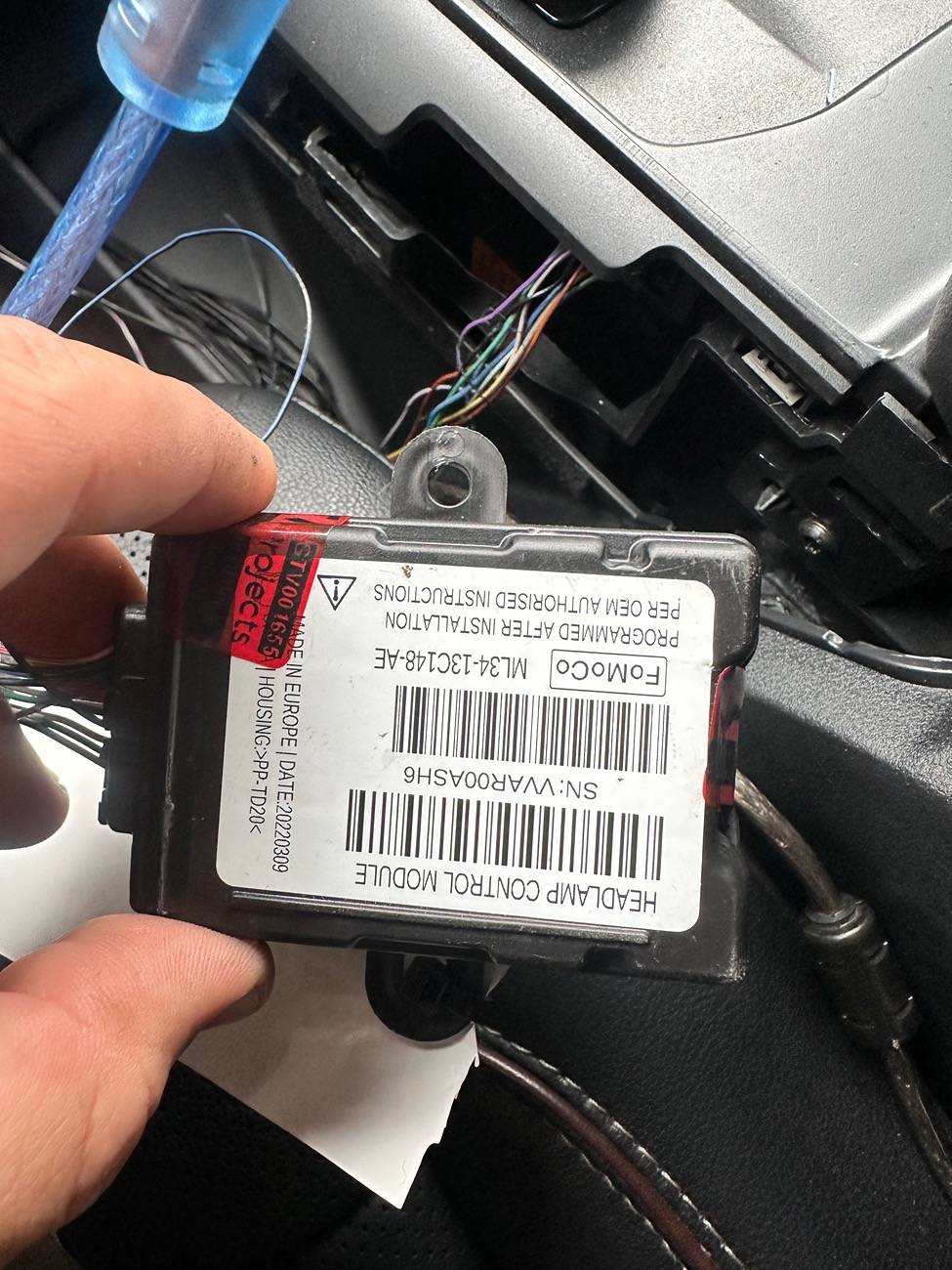

Hi,
I have a F150 2024 STX 1FTFW2L53RKE30697, and the only thing that I am trying to enable is High beam.
It had original headlamps, but now the headlamps are swapped to LED projector headlamps with part number: RL3V-13E017-Y/W (RL3V-13E017-Z/X)
I bought HCM (ML34-13C148-AE), and connected it to the car
Enabled HCM in BCM
HCM_Available_Cfg (HCMAC)
726-70-02xxxxxxx*xx--
1 =HCMAC PRESENT
I am unsure if HCM fits the 24 model. I connected it, and now Fonscan sees it (still haven't connected height sensors yet). Do the sensors need to be connected to enable high beams?
Added Wire from HCM pin 1 to Headlamps left connector PIN 5, and from HCM pin 6 to Right headlamp pin 5. Maybe somebody has a hint for me? Would be very grateful

Here are some photos. I still havent done PMI on HCM, but there is no u2101 or u2100 errors. Now low beams, drl, turn and park lamps are working perfectly. So, just missing high beams :(
I didn’t need HCM for low beams, drl, turn and park lamps. I’m after the harness and coding to get me High Beams, Bending, Leveling and Glare Free.
