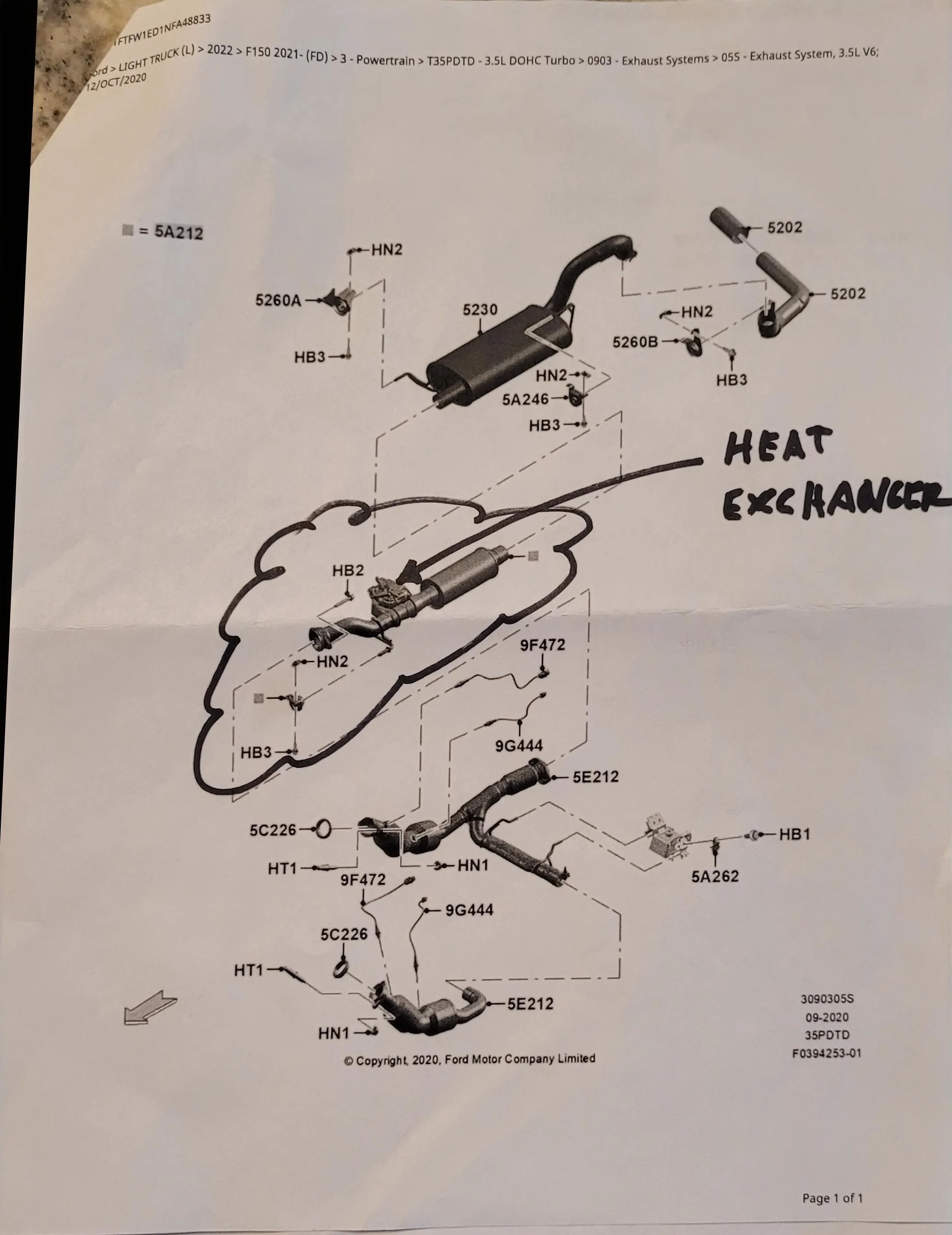

The part number is ML3Z 5A212V. I have attached a schematic showing the exhaust extension and location of the heat exchanger. Hope the dealership can get one in to fix your truck expeditiously.
