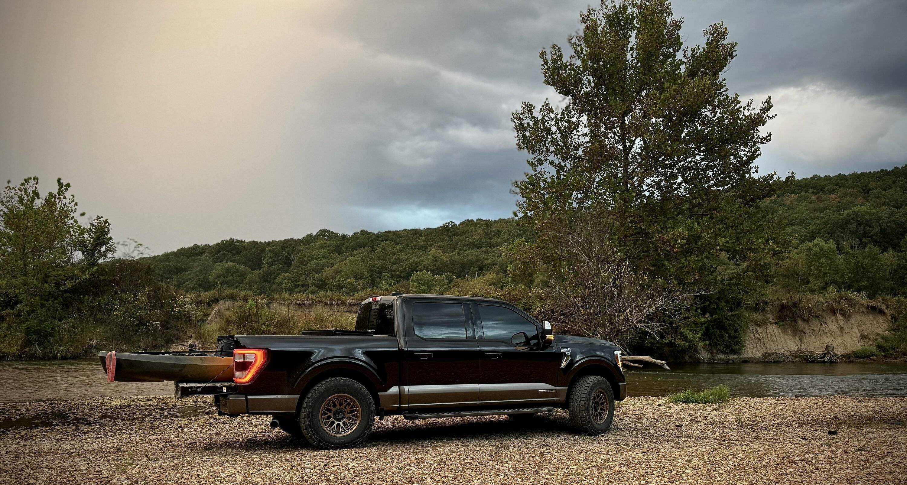

I will start this off by saying that I really didn’t care for the ride quality of my Powerboost with the max tow package and started researching suspension options after my first drive down a washboard gravel road. The back end felt like it wanted to step out and the front was floaty and felt very top heavy. I realize this is a 3+ ton pickup…..but I have 3/4 ton work trucks that handle better than that. If you’ve ever seen the movie Uncle Buck. Then you know his car……my pickup almost felt that bad.
I considered buying front and rear sway bars, but I knew the dampers would need to be replaced to see any dramatic improvement. After doing lots of reading it seemed like Fox was out since they are due for a rebuild every 20k. I’ve run Bilstein 5100’s and they were a good bang for the buck but were a bit on the stiff side. After reading about the Eibach 2R Coilovers most people that owned/used Fox and Bilstein said the Eibach’s were the Goldilocks setup and were comfortable but also provided good performance on and off road. They also have a lifetime warranty. Score.
@Hotshot Offroad threw in a SPC camber kit with the Eibach setup and I was very impressed with the quality. Front was installed and ride height was set 10 full turns down from the factory settings, which sits at 39-5/8” front and 40” rear with the rear blocks removed on 34.4” tall tires.
The ride quality is dramatically improved. Washboard gravel isn’t an issue any more…..no more feeling like the rear end will step out or that “jittery” feel as the rear end skips around. The front end also feels much more planted and less floaty. Huge improvement. It’s not cheap, but it was worth every penny. And this was with 10 ply tires that I didn’t reduce from their 38psi….. I can’t imagine how comfortable it will be when I air down a bit.
I’m a very satisfied customer.

I couldn't tell you for certain if the camber kit was required....I just know that since I had the lower control arm bolts out to get the clearance for strut removal, that I figured I'd throw them in anyway. If I can have more adjustability without more work or $$$, why wouldn't I?
The rear measurement from the ground to the fender was very close to where I started out. The tires being taller compensated for the block being removed. I like the leveled look with less fender gap....and less step in height on the rear bumper.

The pickup is taller.....I couldn't tell you how much though. If I had to guess, I'd say 2-3 inches taller at the roofline.
I was very conservative with my lift, but I was aggressive with my tire choice. I really like filling out the wheel wells and not lifting any higher than absolutely needed.
If you went with a 285/70 or even 33x11.50 you would be another inch shorter than the tires I'm running and could acutally run the suspension a bit lower than I am. I already wish I would have went that direction, just for the fuel mileage . I've taken a little bigger hit than I expected, it isn't terrible, but I haven't seen anything over 23 mpg around town as opposed to 25+ running around on the stock 20's with BFG's.

If you want an extra 2” (or possibly a bit more) you can leave the collars where they are.
I didn’t want that much lift in the front, so that’s why I went 10 turns down.

I figured I would post an update on the Eibach Pro2R kit since I’ve had some time to get mine dialed in and put about 4000 miles on it.
I will say that I was very unimpressed with the OEM suspension on my Powerboost with the max tow. It felt like a top heavy 70’s Cadillac and actually made my daughter car sick during a trip through the Ozark hills. It would pitch and roll so hard while I was hustling on some back roads or around traffic circles. I get it……that’s not what the F150 was meant for, but my last vehicle was a track ready VW that made me search for the next apex. I know the F150 is limited in its handling abilities , but I knew that a quality coilover and shock combo was needed to at least keep some of the unwanted pitch, roll and squat from making my passengers feel seasick!
I’ve had Bilstein 5100’s on previous half ton pickups that I’ve owned, and they were fine. But they were on the firm side. This Eibach kit seems to be an awesome compromise between comfort, handling and road manners. I haven’t had it off road yet, so I can’t comment on that. I will say that gravel roads are much more enjoyable with the Eibach kit. I used to have to creep around on washboard gravel with the stock suspension or else I’d feel like the back end would just push wide and wash out, even with 30 psi in the tires. With the Eibach kit, those same roads were a breeze and I even had 38psi in my tires which should have made it much worse…..the shocks and coilovers just made that much of difference that I could drive quicker over the same washboard surfaces.
I installed the Eibach kit and ended up going ten full turns down which is roughly 1.25” of lift (not exactly sure since I made the adjustments when I swapped wheelsets). I increased the caster from 5.5° to 6.4° to clear the mud flaps when I’m reversing at full lock since I chose a 34.4” tire. I also had to hammer the front crash bar just a bit due to the extra caster.
Reverse leveled rear
-0.2° camber
6.4° caster
0.04° toe (both sides)
