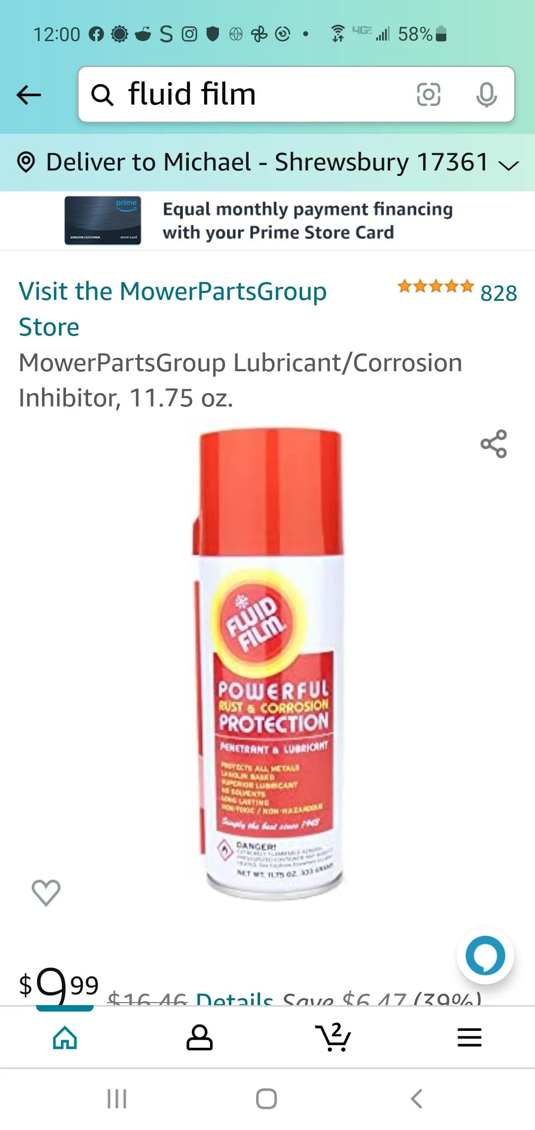

I had the same issue, everything was properly torqued and no broken parts.
I sprayed Fluid Film between the leaf springs and the noise disappeared.
9663mu
Chad
Mar 16, 2021
928
929
Agoura Hills , Ca
2024 Powerboost 157
Can you please share what fluid you used ? ( link please)
