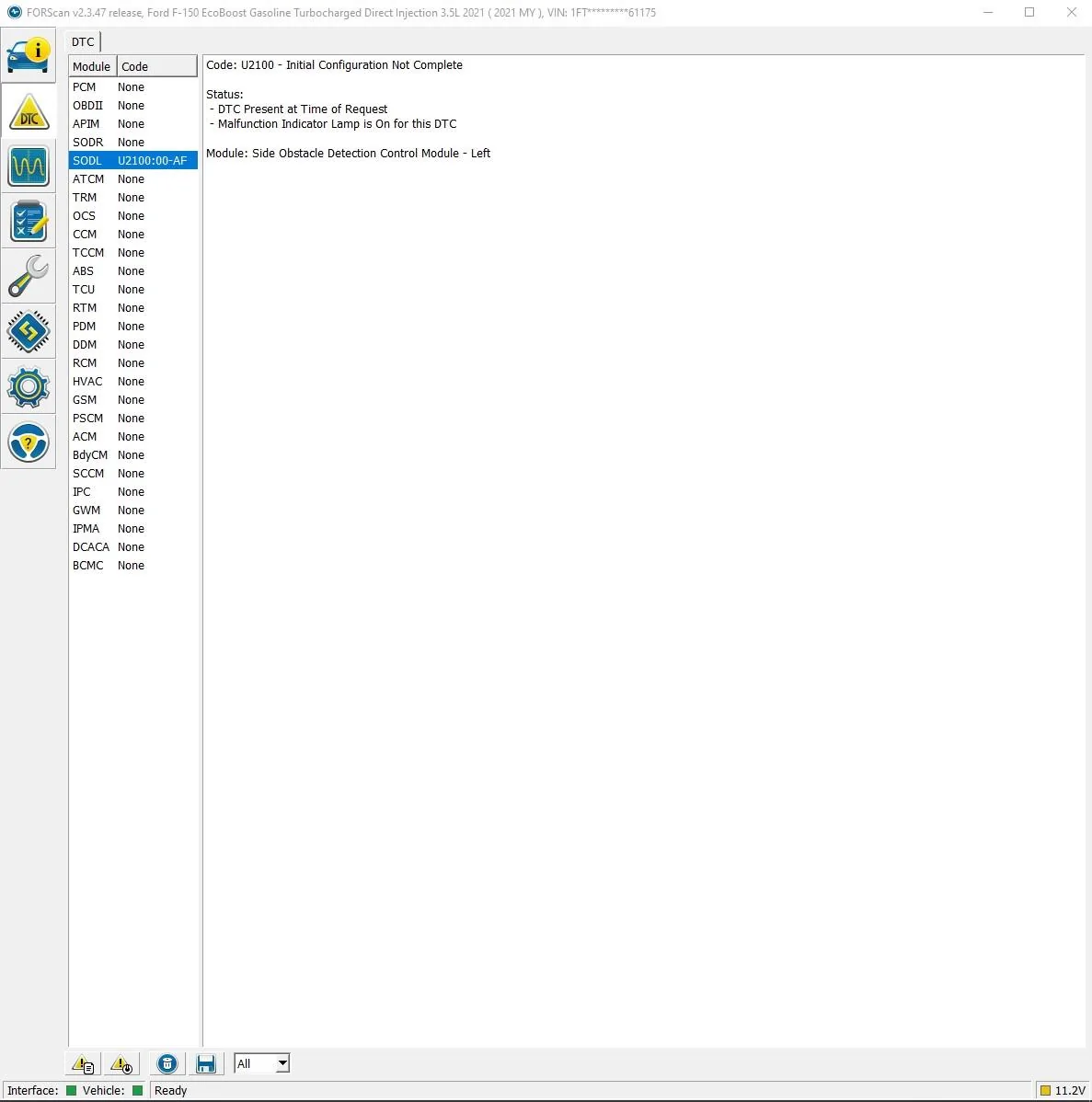

I have had an issue for a while.
My truck got bashed the first week I owned it. The shop replaced a lot of the left rear, whole left bedside, light (not sure about the actual sensor), tailgate, bumper, etc.
My sync got stuck on the 1.7 update, so I came here digging around and that spurred me to get the Tool and run forscan just to look around. I had seen this DTC then as well but since I knew I had to take it in I didn't do anything other than try to clear it. The dealership fixed the update issue after a few attempts. Turns out they didn't do a comprehensive check into the system?
So that brings me to today. I realized I am now not getting power up updates. I am pretty sure I saw a note saying no updates if you have any DTC's. Well looking in forscan again, this one is still there and will not clear. I have no idea if this is something I can fix or if I need to take it in. Any ideas?
Can I "configure" the side object module? Tried resetting it, forced a write with as built info (was already as built), physically inspected it and the connections, everything seems fine. Pretty sure it even works as expected.
(I sat in there so long poking around I killed the battery enough to where it will not start so I am waiting for it to charge....)
U2100 - Initial configuration not complete.

Means they replaced it and never PMI the module. Just need to have FDRS or the Dealer PMI it

Did you buy it new? It won’t prevent an OTA but that code sets when a new module is not PMI. The PMI sets bits in the rom that tell it the initial config has been completed.

I am pretty sure Jesse is pointing out that FDRS is the tool for running the "PMI" routine.
I wish I knew more about how it all works, but even if I did I don't think Forscan can substitute for all of the functionality of FDRS. You might require FDRS to clear the DTC.
I did not know that OTA is automatically disabled because of a DTC. That would be odd if it was true about every possible DTC.

No those are in the rom. Only accessible by fdrs since it’s not the part number for your truck it won’t PMI in fdrs either
