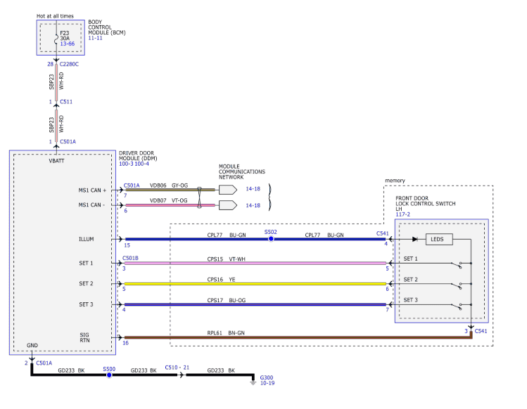

Does anyone have a schematic or connector diagram for the driver door control switch ML3Z-14529-CC? (I'm adding power fold tow mirror capability). Thanks.

This is the mirror wiring.

I did this upgrade. I bought the wire harness from Boosted grey goose design. There is several wires need. Mine also power extend.
