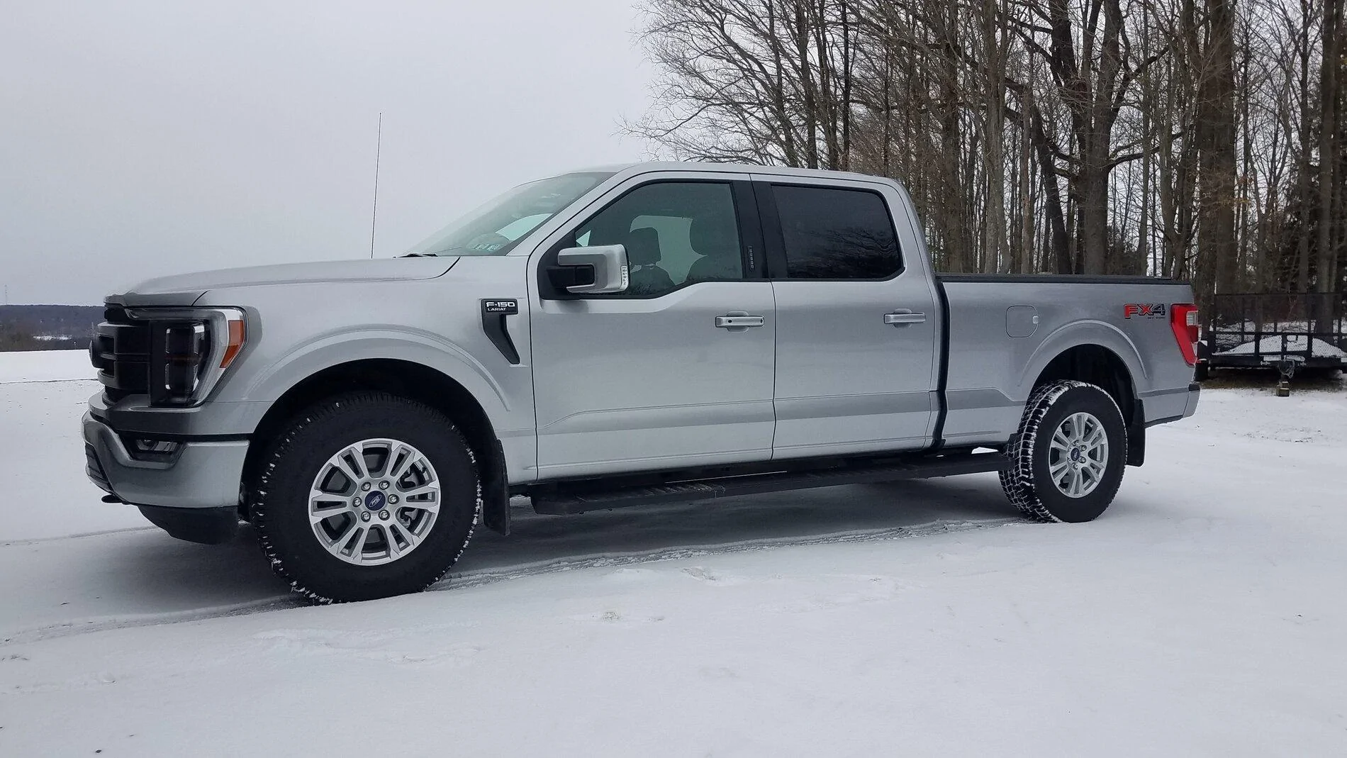

I use dedicated 275.70.18 in the winter. I have Ford splash guards. No rubbing. I have winter tires specifically mounted on 18" Ford OE wheels.
I have 275.60.20 "3 season" tires.
I chose the Continental Tires. Highly rated on both consumer Reports and Tire Rack
Your choice of General Tire is an excellent one. APT Also rated well and a lil better in snow than my Continental is rated. ATX tread was to aggressive for me... BUT... IF you want a Tremor "look" that tire fits the part. ATX will have more Audible Rooad noise. I am getting older and went for the quiet, good handling Conti's ... (but they look way better than my Hankook Dynapro's Imo)
My 2 cents :)

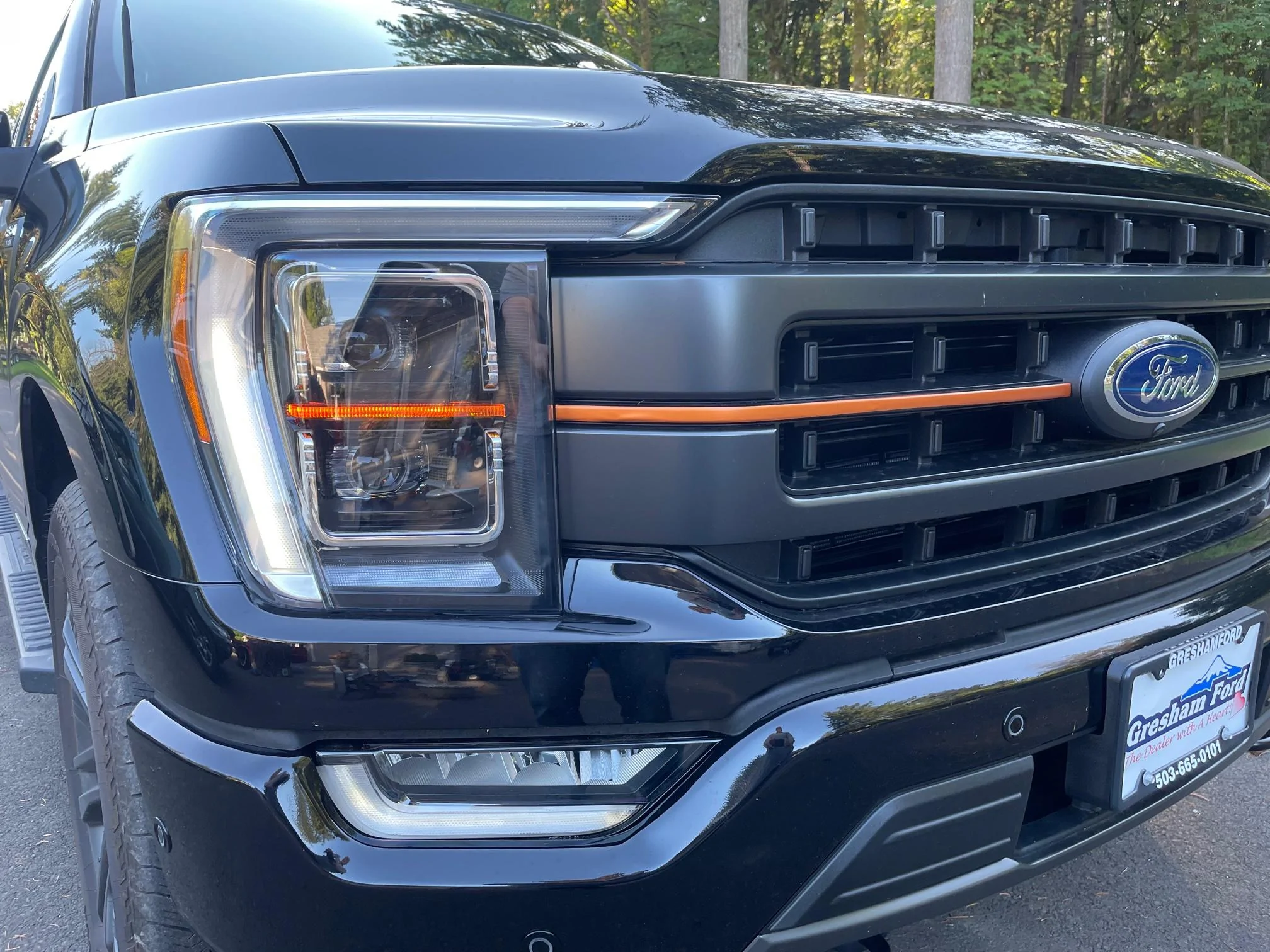

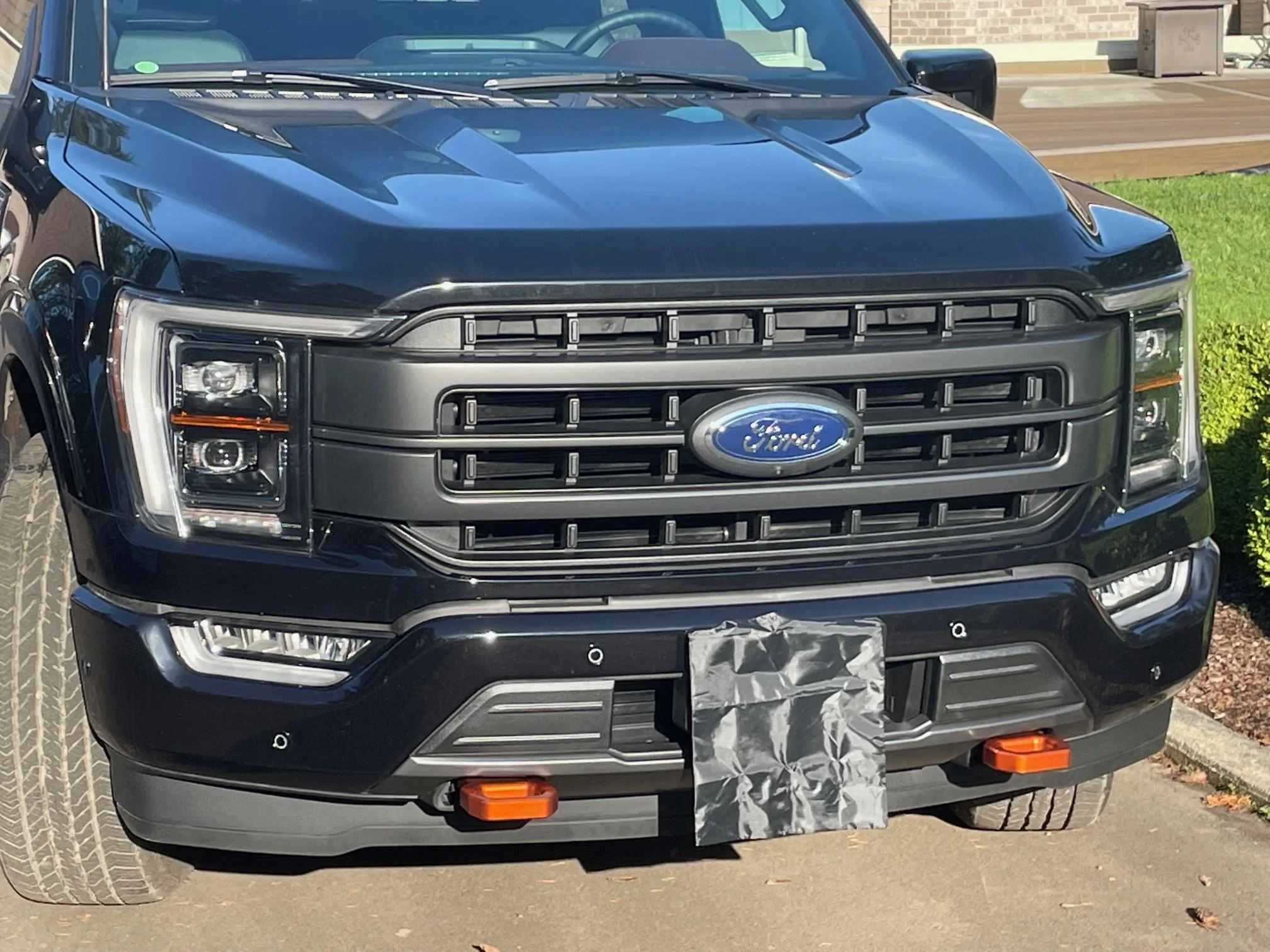

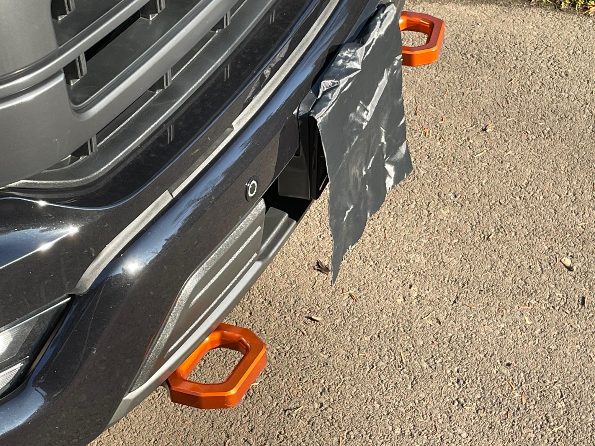

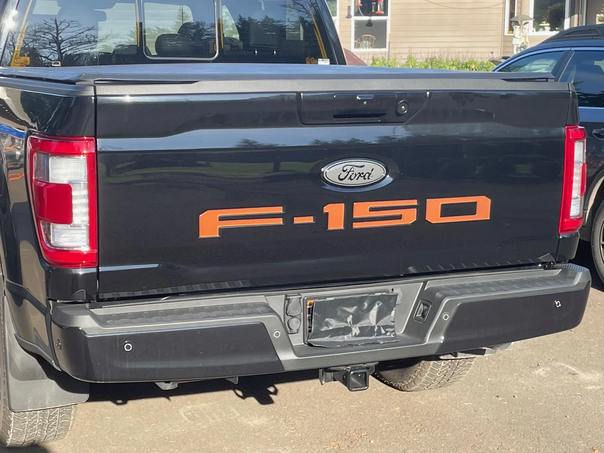

title caught my attention. i want to put the tremor hood (and grill cause i think they have to go together), and rear bumper on my 6.5 bed powerboost.
Just add the color highlights to your truck that mimic a Tremor and even the Tremor logos can be added. The Lariat sport grille has same bar through center that Tremor has. I am highlighting my black Lariat powerboost to mimic a Tremor but I won't put Tremor decals on. I just like the highlight trim but I chose a better color that is a copper color with hint of orange. I don't think the Tremor hood is that big of a deal. Someone probably have some dummy vents that could be added to a stock non Tremor hood. My color is S344 satin copper canyon 3M 2080 vinyl wrap and matching paint is 2018 Nissan Kicks code EBB. Looks like rich copper with a hint of orange. Pictures don't capture the true shade, they look too orange.
