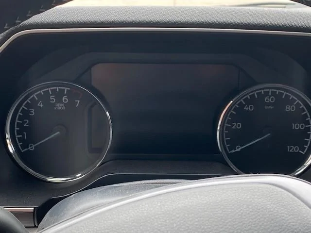

I have the 2021 XLT 3.5L powerboost supercrew. I am not sure about the instrument cluster...here is mine:

It looks like you have an primarily analog gauge instrument cluster. Do you have the ability to adjust 'My Views'?
My 302a XLT middle section is entirely digital screen. The outside big dials are just like yours.

Can you post a picture of yours?

So, I went to the dealer. I do not even have MyView. I did not get the 302a package, nor did they even let me know that was a thing. Oh well, guess I’ll just live with it.

The XLT 302 package has the larger center touchscreen that is standard on the Lariat & above.
The 302 also has the "mostly digital" gauge cluster that supports MyView screens and customization of the top 4 gauges.
Figured it would be good to post these since so many of the interior photos show the full digital cluster.
