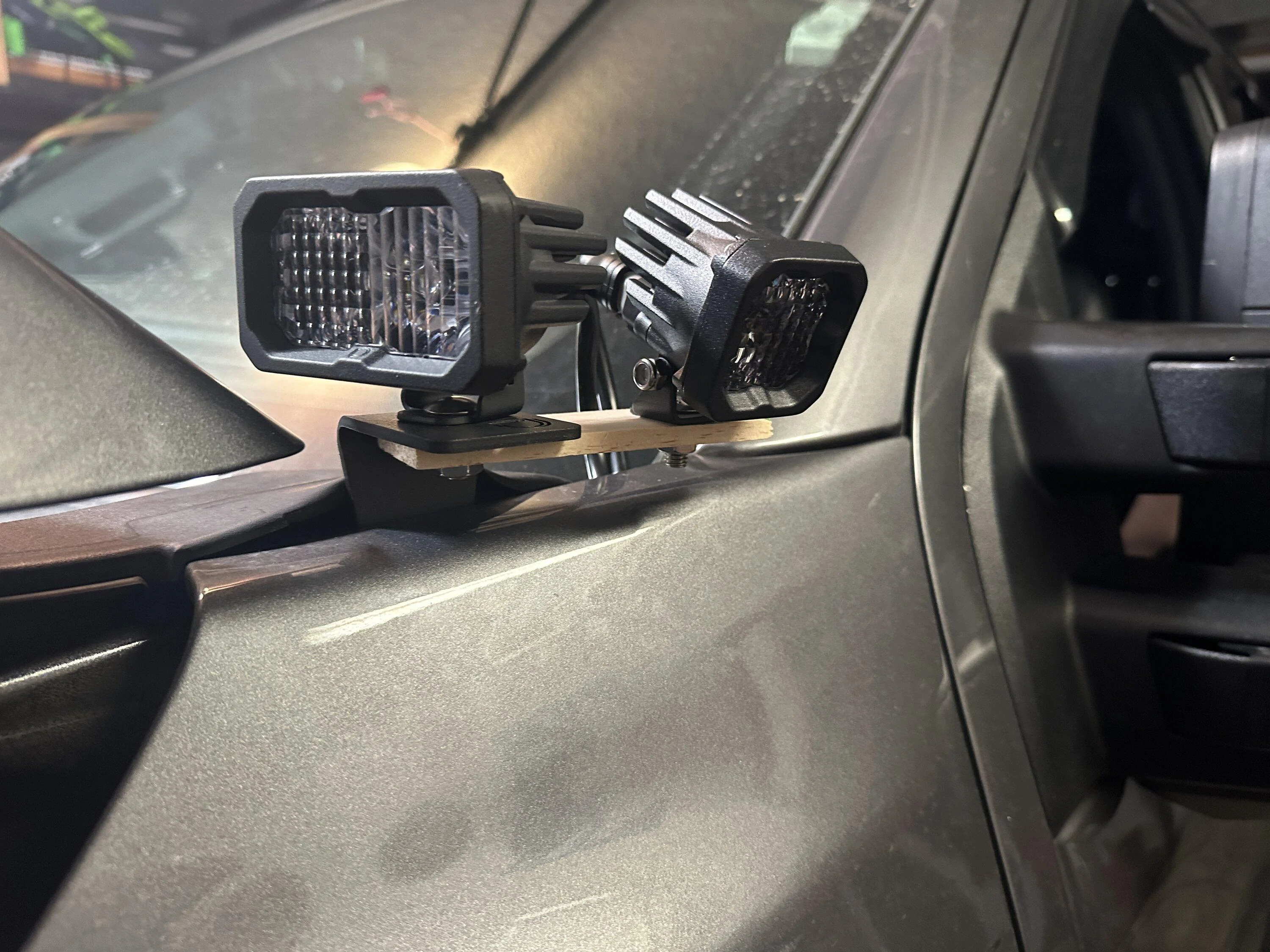

So I decided I liked the @Diode Dynamics SSC2 Pro lights over the SSC3 for my truck because they are sleeker being less bulky. I don’t off road and I just like having auxiliary lighting for darker roads and what not.
I didn’t realize at the time that the SSC2 don’t allow for the SSC1 pods to be installed on the mount like the SSC3 so that was a bummer. Anyway, I waited until their next sale which was the Summer sale and picked up a set of SSC1 pods.
I made a mock up with a paint stirrer from Home Depot to see how I liked it. Some companies sell bracket extensions but they are very long from online dimensions and I only needed 4.65” from what my cheap caliper gauge said.
Here is the wood mockup which was far easier for me to work with at 11pm in my garage.
Ford F-150 Diode Dynamics ditch light mod IMG_9239
I then used my highly accurate cutting device (sawzall) and cut a piece of aluminum flat from Home Depot and made these.
Ford F-150 Diode Dynamics ditch light mod IMG_9240
I then added these to my ditch light bracket to have the SSC1 pods pointed at nearly a 90 degree angle so I can light up my sides.
It leaves me with this as a final result. I’m not sure how to coat the aluminum so it’s black, I’m not very savvy in that and usually I use an appliance epoxy spray and throw in the oven to bake on, but not positive that works on aluminum? Anyways just wanted to share in case anyone thought of doing similar. The piece of aluminum flat cost only $13 and I have plenty left to try something else if needed.
Ford F-150 Diode Dynamics ditch light mod IMG_9241

That turned out sick!! You could have those pieces powder coated or spray paint them with a rustoleum type paint!!

Thank you!
I was surprised they didn’t offer anything for this and the extensions I’ve seen that are directly to the side would stick out way too far and would look odd.
I’m very happy how it turned out and glad I could make my own exactly how I wanted one.

Are they wired together or separately? Where did you mount the switch(s)? How did you run the wires under the hood and where did you go into the cab? Did you use a fuse?

I installed the factory Upfitter switches so all wiring is on the passenger side under the hood just connect the power wire to the corresponding switch.
I wanted to be able to power the left and right independently so I had to make my own wiring using the supplied Deutsch connector. With that as power to each light I used one of these splitters
Ford F-150 Diode Dynamics ditch light mod IMG_9246
This way both lights come on with their corresponding left or right side switch. The Upfitter switches have their own fuse box as well.
