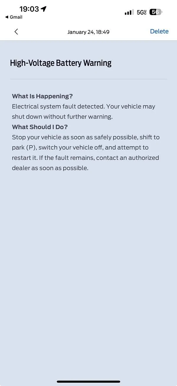

Installed brand new digital gauges tonight and I’m having a few issues. Uploaded my as built data no problem at all. It will not let me update the mileage and I’m not sure how to put in my engine hours. When I try to program the mileage using odometer write on Forscan it makes it to 2% and then says service procedure has been interrupted. How do I fix this? Ford Pass also says I have a high voltage battery warning dtc that doesn’t even come up on Forscan

I will try that tomorrow morning. Anything I can change to make the high voltage battery fault to go away? I do not have a powerboost

Did your IPC come from a Powerboost or was it originally programmed for a Powerboost? It might have triggered that DTC before being overwritten with whatever your configuration is.

must have been programmed for powerboost in a past life I guess. How do I change that?
