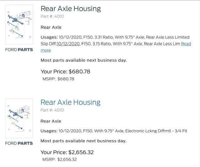

Max Tow rear axle is indeed beefier as well as 3/4 floating:
Ford F-150 Difference between Tow Technology package and the Maximum Trailer tow package? 162B460C-2023-4ECA-8EDC-EC8DBBDB07DD
This is only comparing just the two 9.75" axle housings, the 8.8" is standard for a lot of the trims/configurations. Though 3.73 gears will always be equipped with one of the 9.75" axles.
