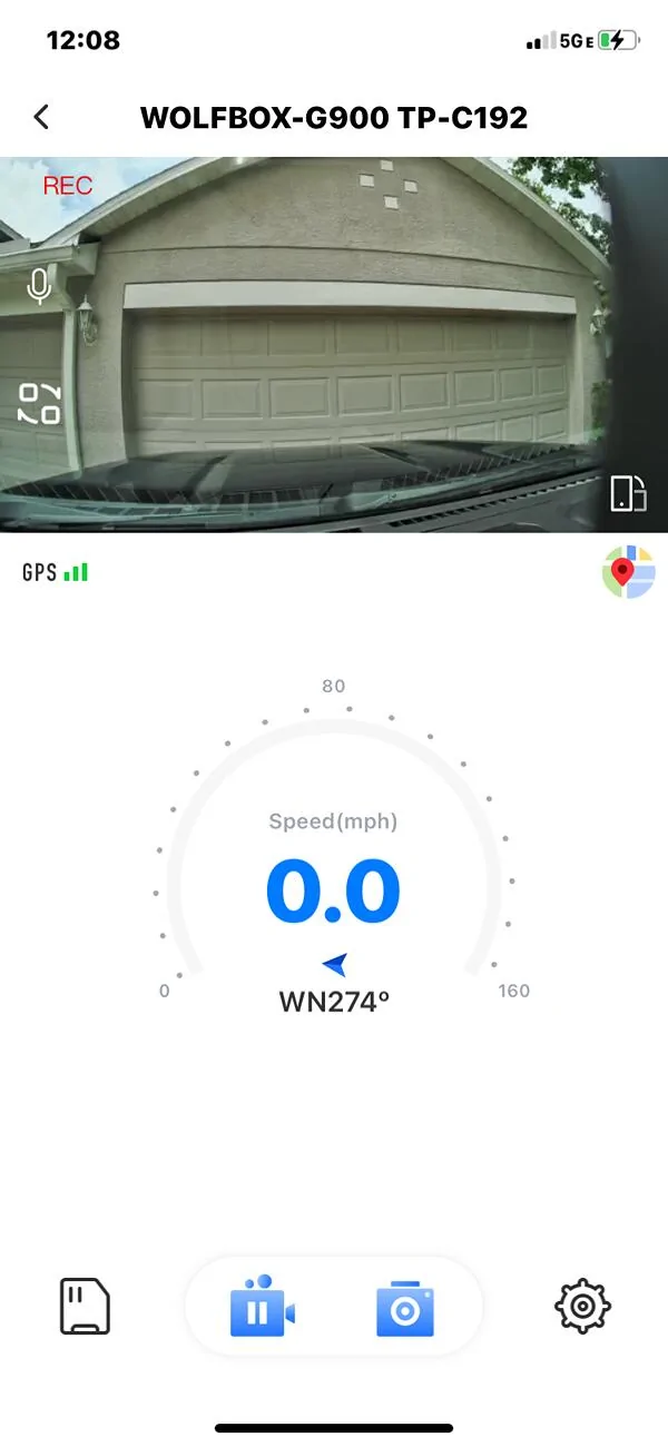

App:
Ford F-150 Dashcam Wolfbox G900 Tripro Bumper Version Review IMG_1840

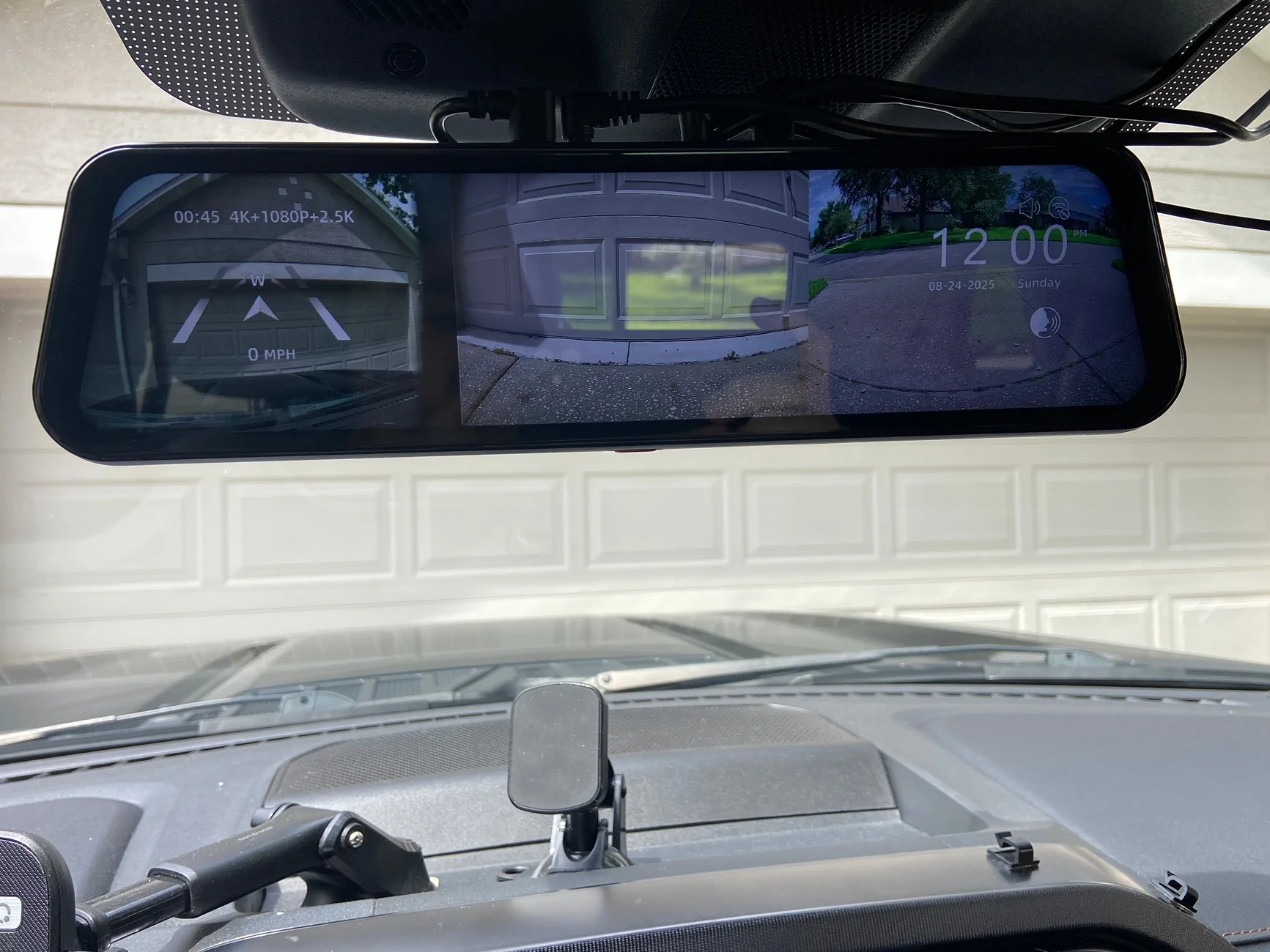

Tri-View (Split screen all three cameras on mirror)
Ford F-150 Dashcam Wolfbox G900 Tripro Bumper Version Review IMG_1838

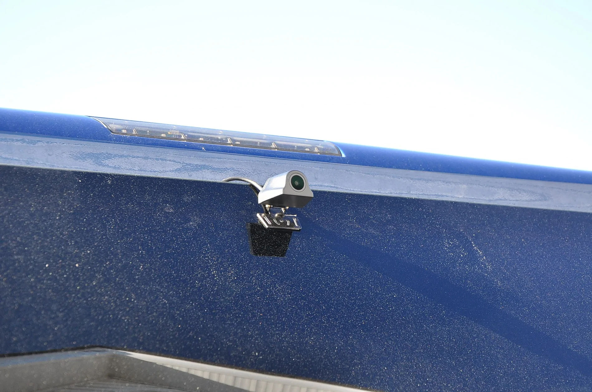

I ran the cable from the mirror and down the frame and out of the floorboard gromet hole that is used for this purpose. Then the cable ran under the truck and up into the bed. Then up to the roof of the topper and I mounted the camera on the outside top of the back glass. You will see in the pics.
I have it mounted with the heavy duty velcro type fasteners that are used for EZPass and other windshield toll devices. These are easy to by on Amazon and they will not bake off in the sun. They stand up to anything.

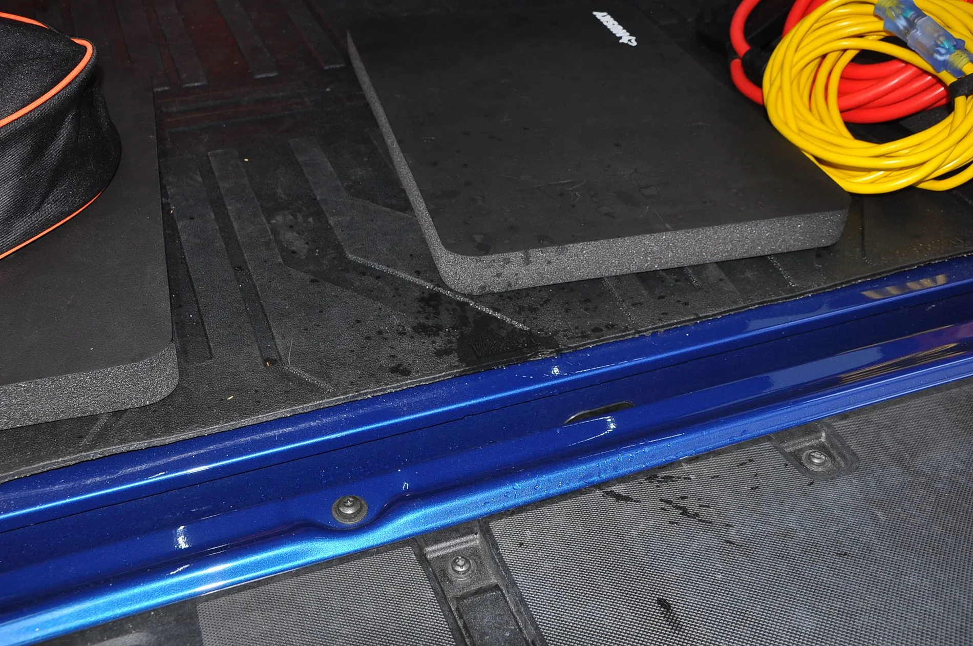

I just run the cable out through the rear window seal to the camera. I have had this set up in hurricane downpours and nothing more than a couple of drops get through. You will see in the picture. This was after one of the hurricanes came through and it poured all night. This also lets me remove the camera when I run it through a car wash.
Now the rubber seals for the rear window on the ARE topper are outstanding so this may not be the same for all manufacturers, but it works like a dream for mine. With the camera nice and high you get a great view of the action behind you.

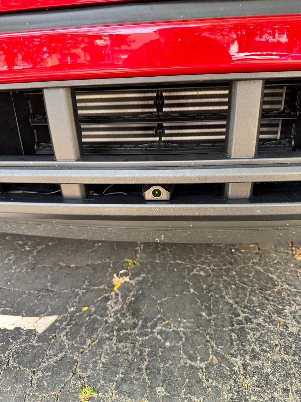

I bought the Kit watched several videos on installing it. Got the mirror mounted and ran the front camera on the bumper. When you don't Have the 360 camera and you have to nose in places it makes it nice. Still need to finish with the rear camera. So far I'm impressed.

Care to share where you mounted your front camera? I’m trying to get inspiration of where to mount all this and eventually purchase/install. Thanks!
