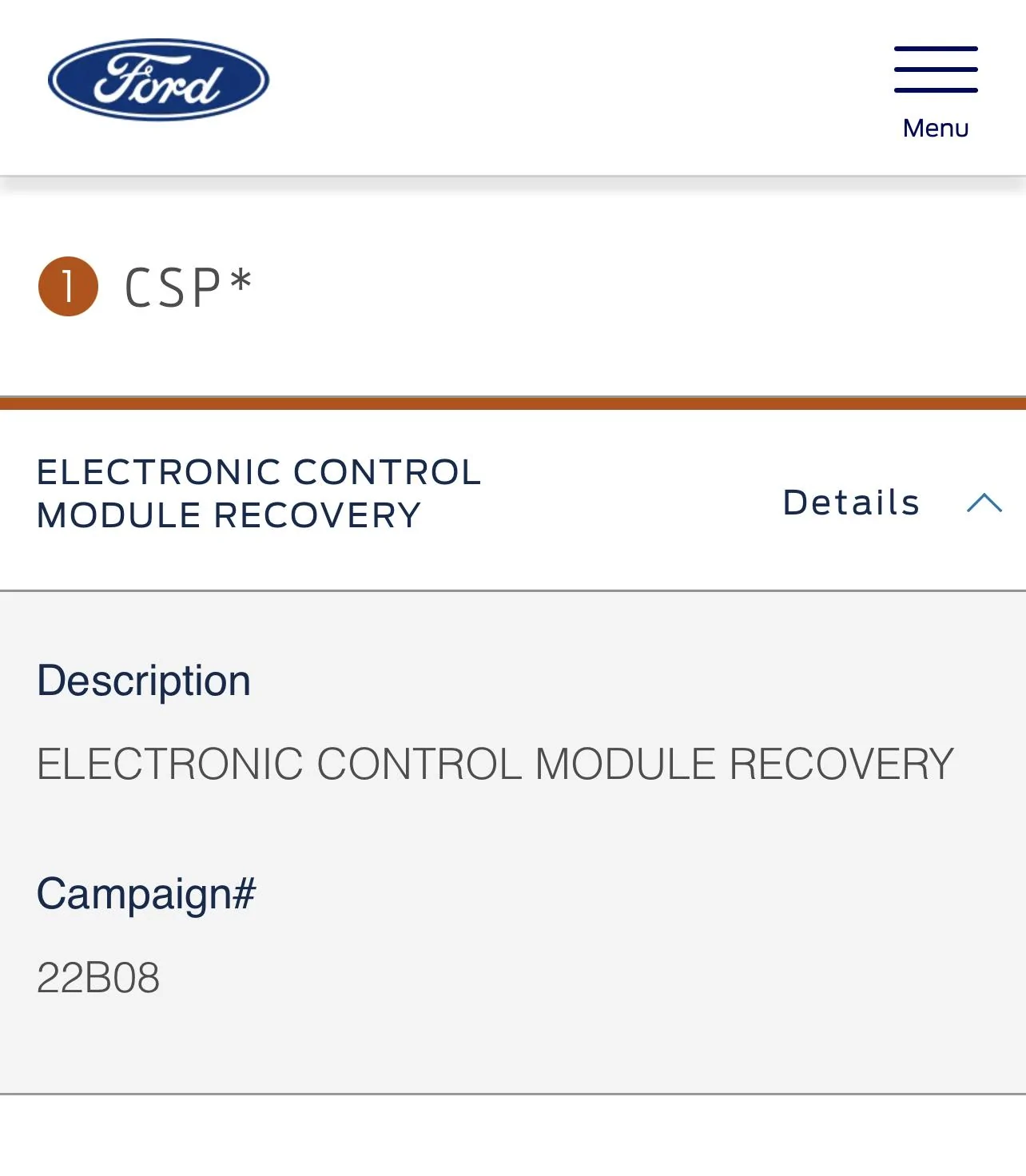

Has anyone seen this or received this before. This came up on my FordPass today under recalls and I can't seem to find any information on it.

A new search brought up results on the MachE forum. Apparently, it has to do with TSB 22-2150 and is time sensitive.
