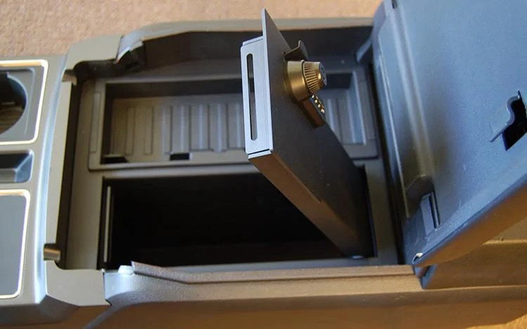

That doesn’t look like mine
I never bought the Ford one because I like the fact that the other one leaves half the console still open and usable while the other side can be locked up if required. It is also a fully boxed steel container and not just a top.

I edited after I looked at yours more and you have the angle in front too. I thought yours was more square at first

Does anyone have this console safe in their Gen 14 F-150 or know if the center console is different from the previous generation on the inside? This safe is listed to fit in the 2020 F-150 but not the 2021+.
https://www.bnvproducts.com/products/center-console-safes/2015-2020-ford-f150-console-safe-half-box
This is what I would like to get too. There is another thread about this but it never got an answer as to the fit for the Gen 14. I think it might fit but require some modifications. With that said this was on my list of things to explore but it is down on the list. I need to get my truck first.
I thought about using the full one for measurements to make a "template" to see if it would fit. Also I believe you will have to match up the bolts that go through the bottom to see if they are the same or if new holes need to be drilled.
It could be very simple but it may not be also. It is a project unless the manufacturer can offer any guidance.
The bolts are just drilled through the plastic in the bottom of the console and are fastened to provided metal plates that go under the entire console so that shouldn't be a problem. I am just not sure if the top plate of the safe fits inside of the console and also if the depth is any different on the new trucks.

The consoles are different in the front around the top. I tried a 2020 model safe in my 2021 and although i did get it in their with heavy metal grinding I was not able to remove when i sold the truck for a 22. Mine was a different brand so can only talk for it. But they now make it for 2021+ https://guardiansafeandvault.com/
Thanks for the link. Yes I know I have seen those but finding the half-safe half-open model is a tough one.
Yea I like that too. I might just get one and mod it again. Way less material so should be easier . Only part is the underneath bracket I am not sure about.
