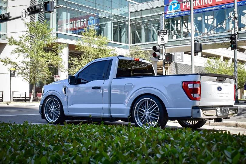

Does anyone have some insight on swapping my manual release tailgate to a power release? I have a power-release tailgate I want to swap onto my truck. I do not need to be able to release it from my key just to release it when I push the button. Does anyone make a harness for this or would I just need some forscan changes?
Ford F-150 Changing manual tailgate to power release? IMG_4101
