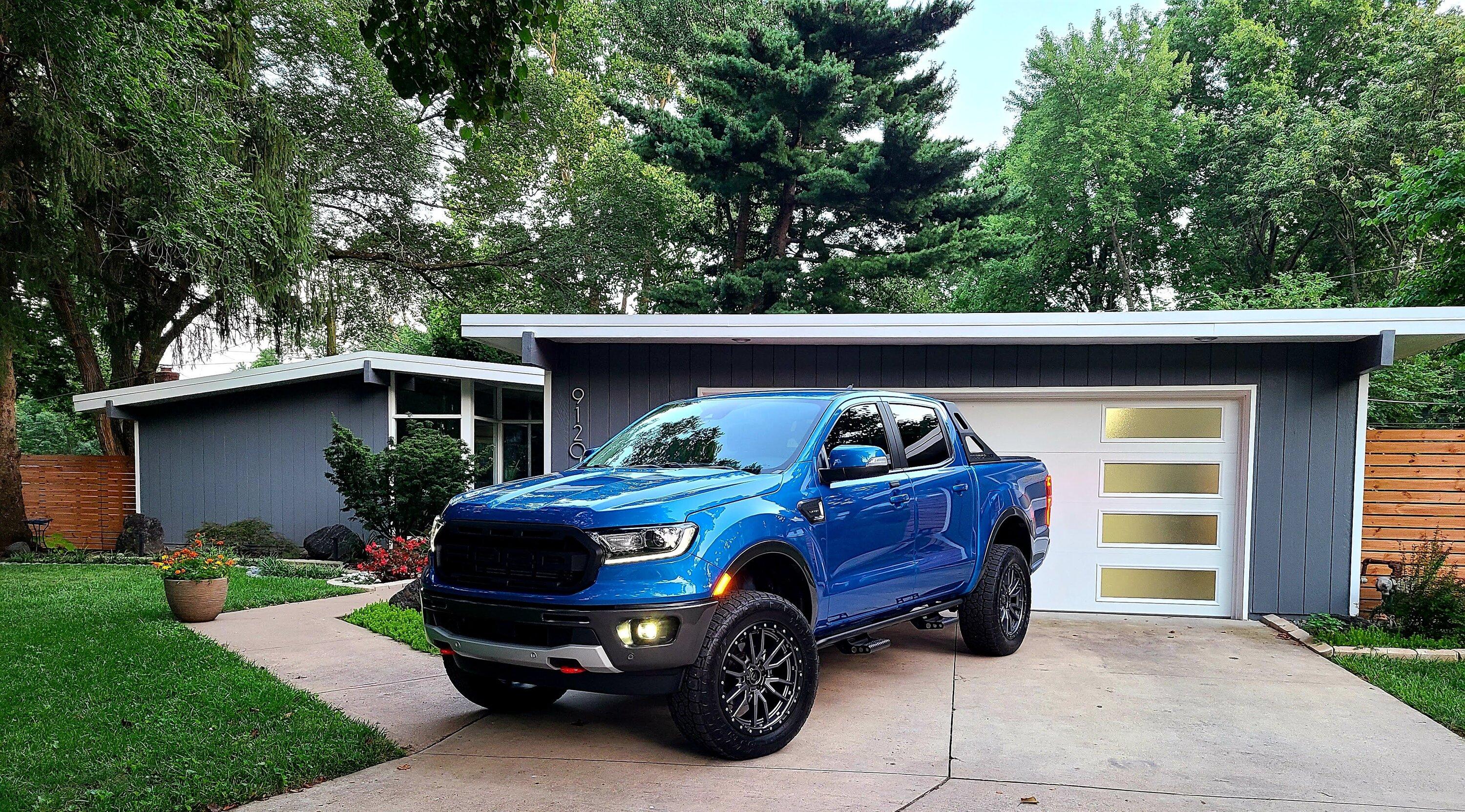

I do my own ceramic coating. Wash, iron removal, clay bar then ceramic coating for a new car. If it is a used one then you have paint correction to take out any swirls/scratches. It is very time consuming but the results are fantastic. I use Autokcan which I like the results for the money (https://www.amazon.com/dp/B07QD58TR...olid=1MW6WUUVCQY8E&psc=1&ref_=lv_ov_lig_dp_it). It use to be $60+ on amazon but is really a good buy right now. Here is my old ranger that was done after I bought it.
