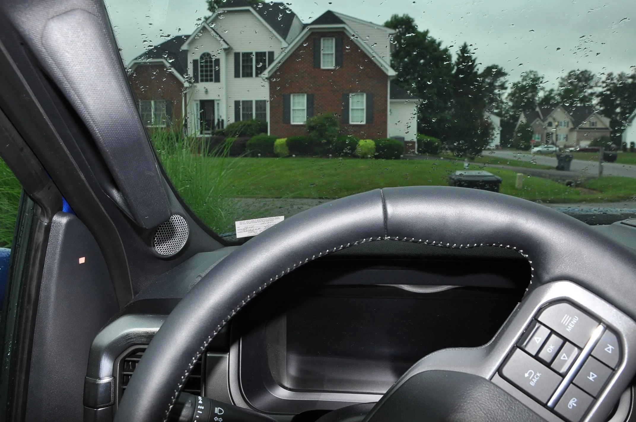

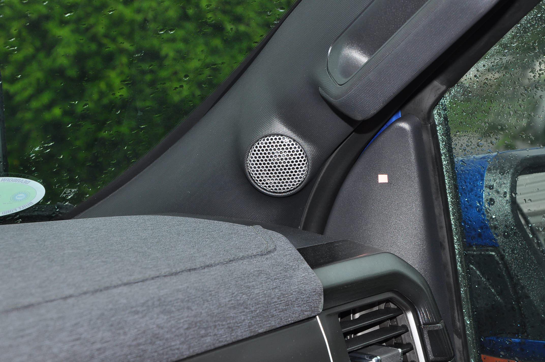

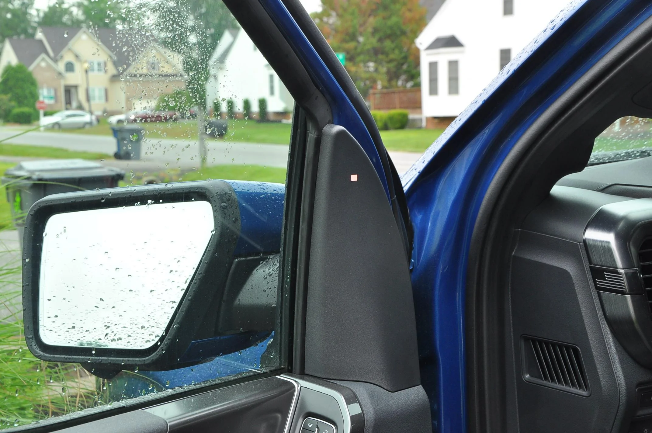

Next step in the game plan. Thanks to those wonderful wiring diagrams from that asset to the community Buyer2021 :) I think this may be doable. Below are some pictures of the interior area that could accommodate this project.
My hope is to be able to remove the small plastic cover on the interior by the mirror. That should give me access to the #13 green wire that powers the BLIS. I would then use a "tap" to tap into that line with one of the small (5mm or 10mm) 12v LEDs. The position of this small LED would be where the pink dots are in the pictures. This interior spot is not the best but also not the worst and it is a good "easier access" place to drill a small hole for the LED housing.
I still have to figure out what to do with the second wire for the LED, but maybe someone has some ideas. I imagine the ground wire would work but I have to see if there are other options. I'll order some lights to play around.
