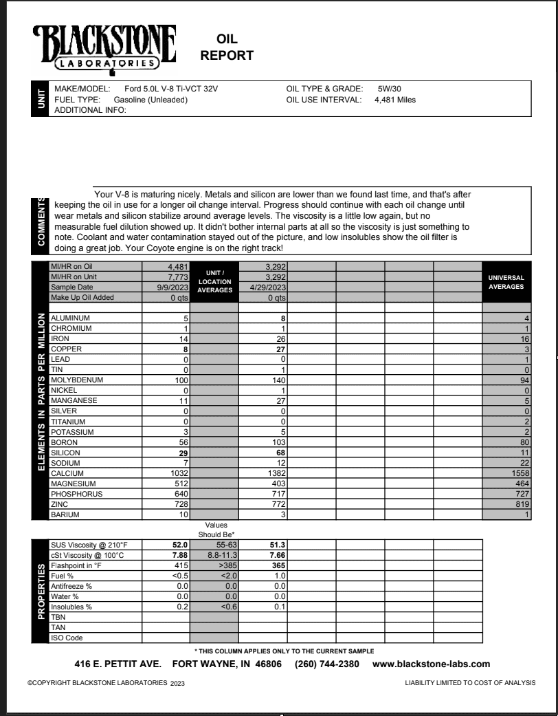

Posting Blackstone results for anybody curious. Motorcraft Synthetic Blend 5w30 done by dealer. Having them do it since I have ford points. Will probably switch to Amsoil FS 5w30 at some point.
Viscosity is a little low for being less than a 5k oil change. Is that just a factor of the synthetic blend?
Ford F-150 Blackstone Report - 2023 5.0 2nd oil change Screenshot 2023-10-05 100305
