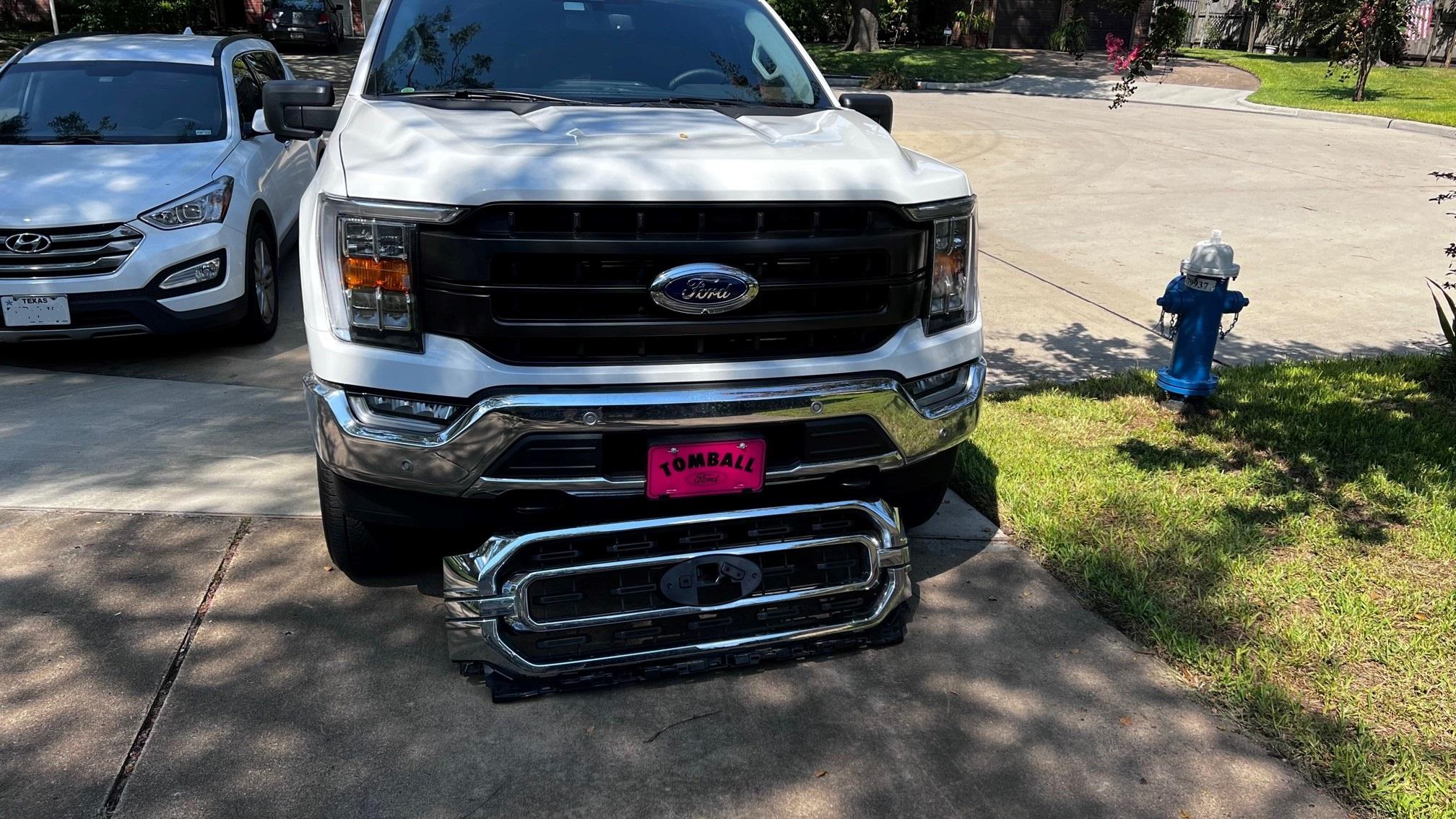

I put a BAP Lariat grill on my XLT. Pretty much a direct bolt on, and took about an hour to do. The only snag I ran into was the 4 large clip studs the louver plate bolts to on the new grill rotated in the sockets so I had to pull them from the chrome XLT grill and installed them on the Lariat grill.

I might have to take a better picture of it , but you probably can see it lines up fine.

That looks like a Lariat Sport grille, not a BAP grille.
You know, it might be. Got it off fleabay for under $200 bucks ands it said BAP/sport Lariat grill. Think the only real difference is the BAP is painted black and the sport is grey/black plastic.
Either way it looks better than the chrome XLT grill. :ROFLMAO:
They're actually quite different and I think you made a good choice going with the Sport grille. There is a gap at the top of the BAP grille for the hood latch that would be visible with your style hood, which is also the reason why I didn't swap mine out. Plus it's gloss black and doesn't really match the wheels and fender emblem of the Sport model.
Well, good to know on that. Mine definitely does not have that cutout or the rectangular design at the outer edges like the one you posted. For sure a lucky one on my part cause I would not have liked having the notch being visible.
