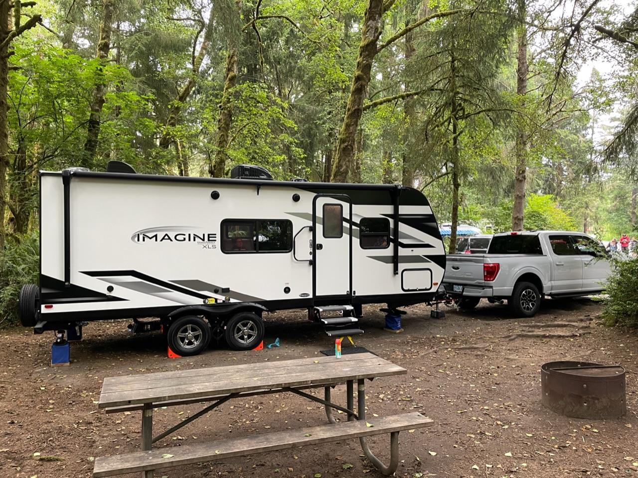

Assuming the Equalizer (E4) that came with the trailer has the correct bars for the hitch weight, go with it.
I would have gone with the E4 if there wasn’t a fitment issue with my trailer tongue.
I’m currently using the E2 trunnion with 1,000 lb bars on my 26’ Imagine 22mle (6995 lb. gross weight) and have been very satisfied with the ride and never feel any sway.
Note, you can back up with the square bars of E2 & E4, but it’s my understanding that you can’t with the chain style pictured above. It’s recommended that they be disconnected before backing into a site.
Not a problem, just be aware.
Even with the E2, If I know we’re pulling into a very uneven/awkward site, I’ll remove the bars while my wife is checking in at the office. Again, not necessary, but does make it easier.
