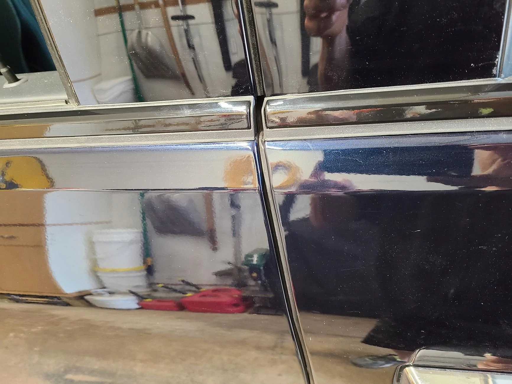

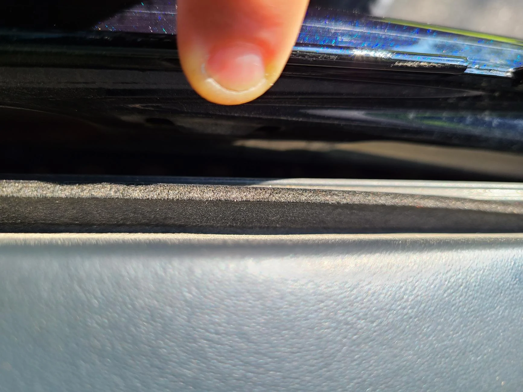

I ended up wrapping mine today in gloss black.
The trick to removing the fronts is to remove the mirror and pull from the mirror side. Once you unsnap the two clips, you have to push the molding in towards the interior slightly to get it to release from the clips. Don't forget the screw.

FYI- I was able to remove the chrome pieces and wrap them and used a little heat and tucked all of the edges. The wrap shouldn't lift around the edges, etc.
If someone really had time, you could easily prime, base, and clear.
