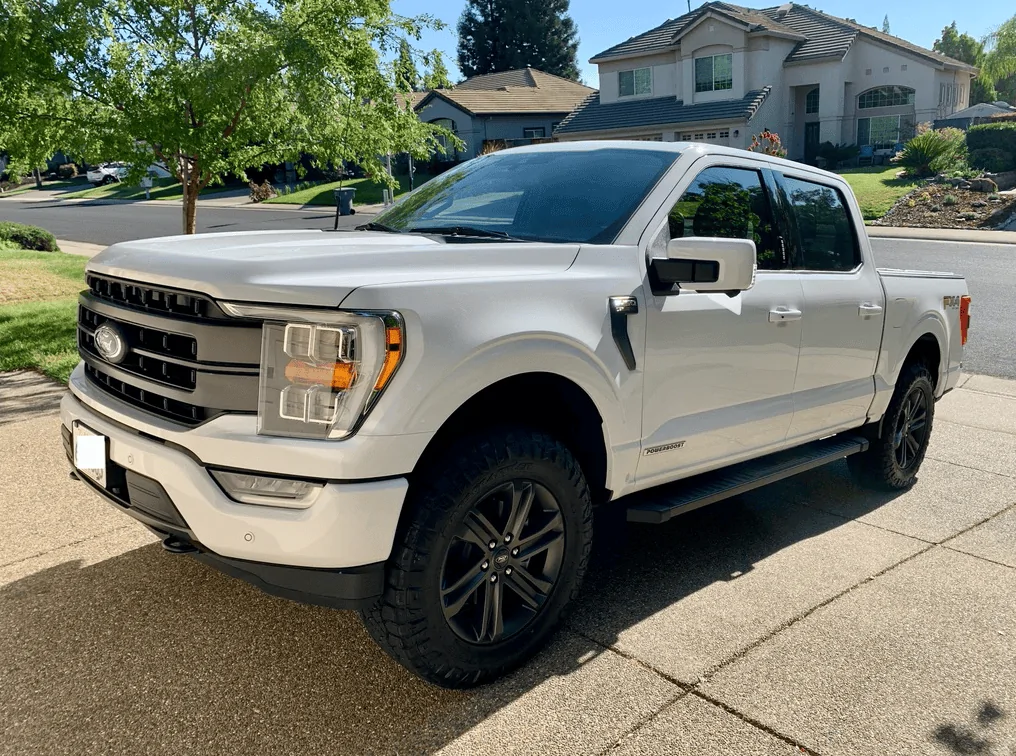

I went with a 2" level and 285/65R20 Nitto Ridge Grapplers on my Lariat PB... I think it looks good without being overly agressive...
Looks great! Do you think they would rub without the level??
