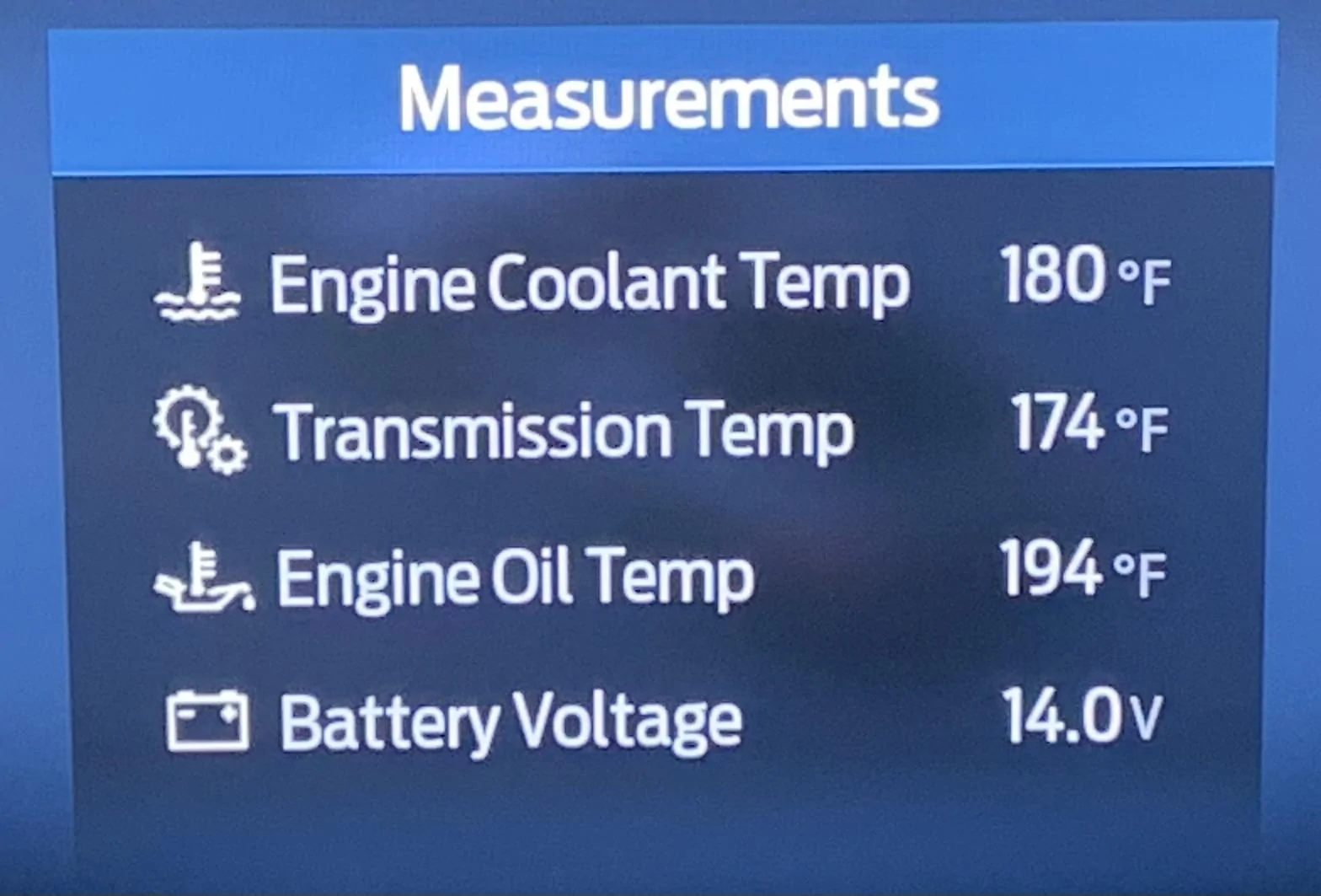

My view on the instrument cluster shows this:
Ford F-150 Battery IMG_6481
Have read a lot of issues about the BMS Does any one know what the 14V is measuring, the battery in the hood, the one in the rear seat or both?

I’m not certain it is reading actual battery voltage, maybe a sensor near the battery.
14v+ is really giving you alternator output.
Most accessories in automotive advertise 12v, but actually are designed to operate at 14.2. Voltage circulating within the truck should be anywhere from 13.8 - 15 on the high end. Both of my old Chevys operate closer to 16.
As soon as you shut the truck off, voltage will drop into the 12s
