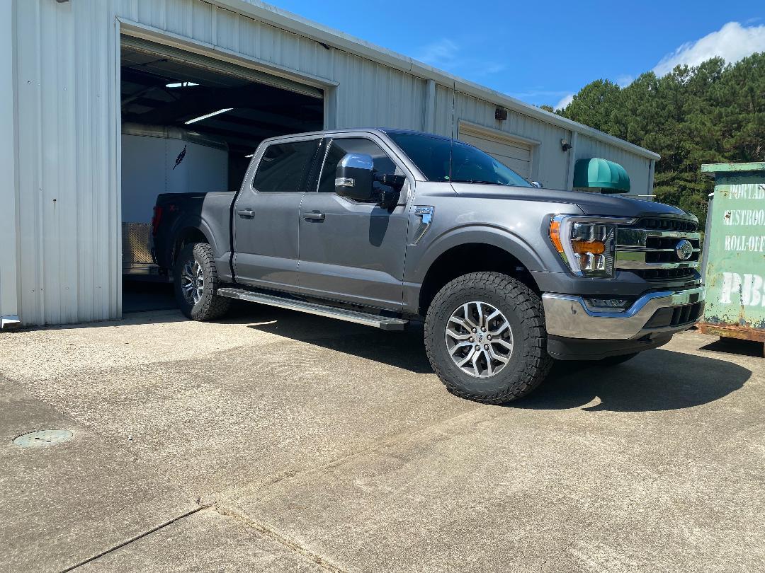

First Modifications. Tires, Level, Tint and Bed liner. I just can't stand raked stance on SUVs and Trucks. Ford has some of the worst factory rakes out there. Just my personal opinion and likes.

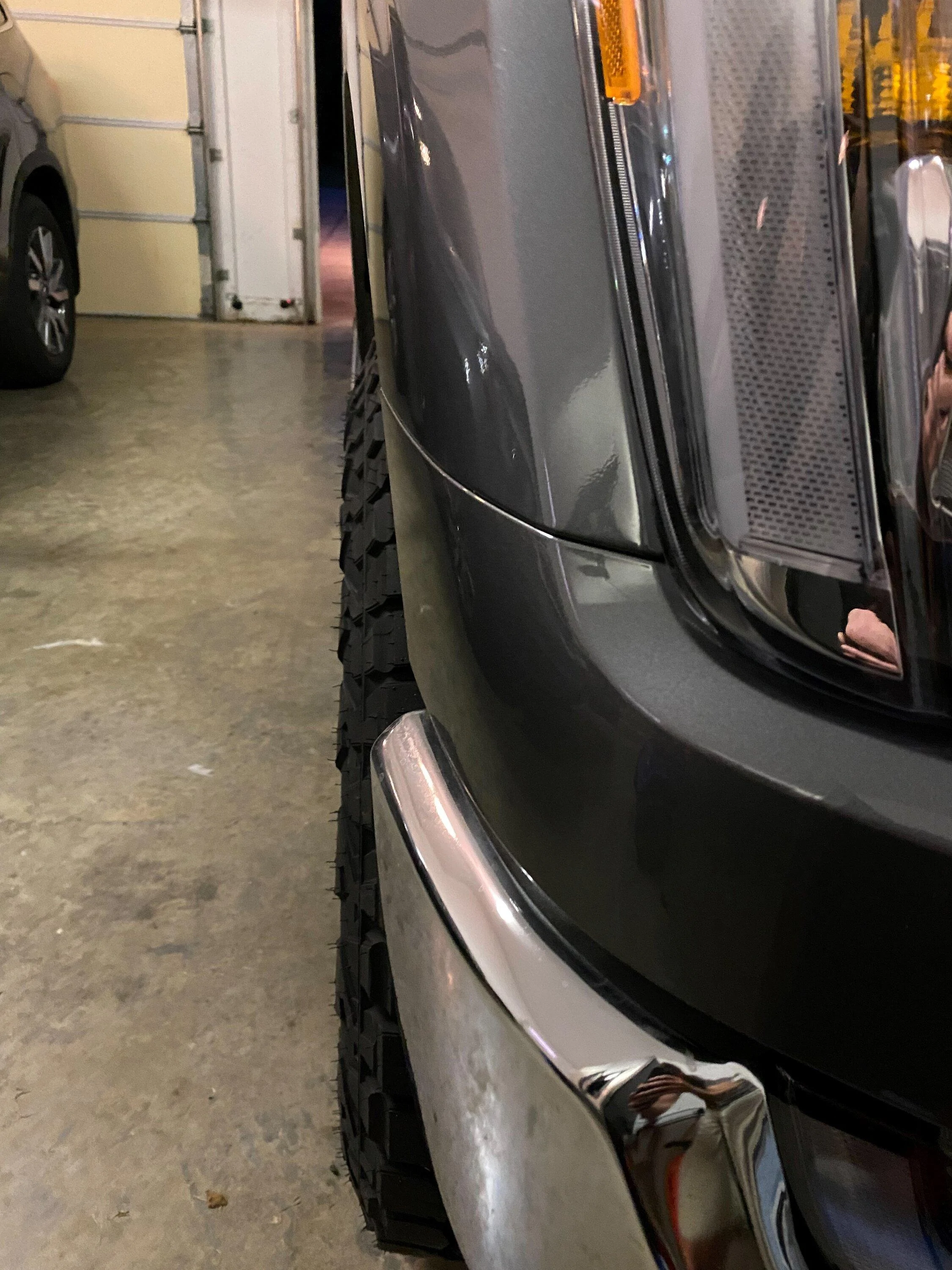

Level , I went with a simple 2" level. Knowing it would leave some rake. See after measurements below
Wheels & Tires, I really wanted 20" wheels and my preference is to oversize a tire on OEM wheel. The Y spoke sport wheel I see on the road a lot, my goal was to differ from the popular choice, and I did not necessarily want the sport package. The 20" Chrome wheel I compared to aftermarket options. I just couldn't settle on anything so I opted for the 18" alloy wheel that comes with the base 500a trim. So far I love it.
I went with the Nitto Recon Grappler 295/70/18 load Range E. Its specs are 34.3" (2" increase), 63.6 LBS (26.6 LBS Increase!) and 80 PSI max. No Trimming and No rubbing. UPDATE May 2023 - Slight Rub in reverse at full lock.

After Measurements with half tank of gas. Tires at 35 PSI
Front Fender 40 1/8"
Rear Render 41 3/4" (Just over 1.5" of rake remaining)
Front recovery Hooks 17 7/8"
Bottom of hitch shank 18 5/8" (Decreased with the level, considering the tires are 2" taller)

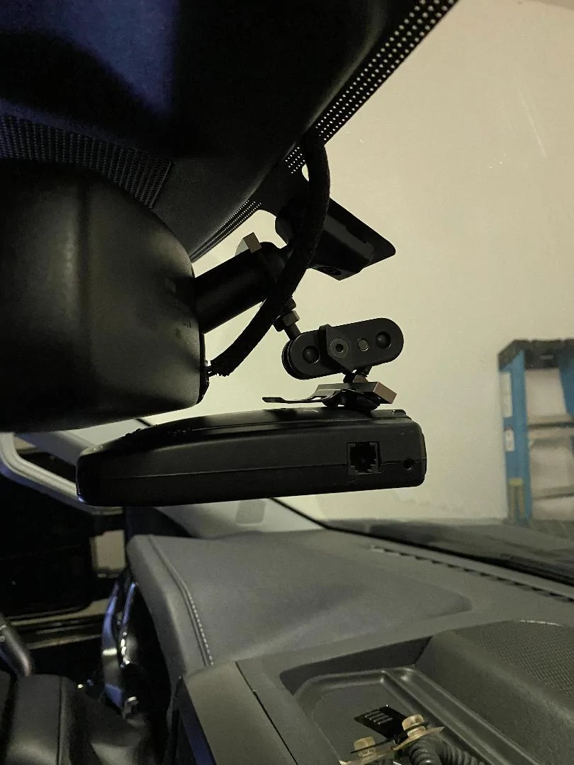

Second Modification. I have all my cars including my Wifes hardwired for our escort radar detectors with the escort smart cord. We both like the have the mute button in simple arms reach to silent the false alarms. Unfortunately the smart cord is not long enough to reach from the interior fuse locations, bottom right passenger foot well to the left area of the center console. Scrapped that and installed the Mirror tap from blendmount. Green is ground. Black is 12V switched power.

Mirror Tap for Escort 8500 once it arrives. DONE
