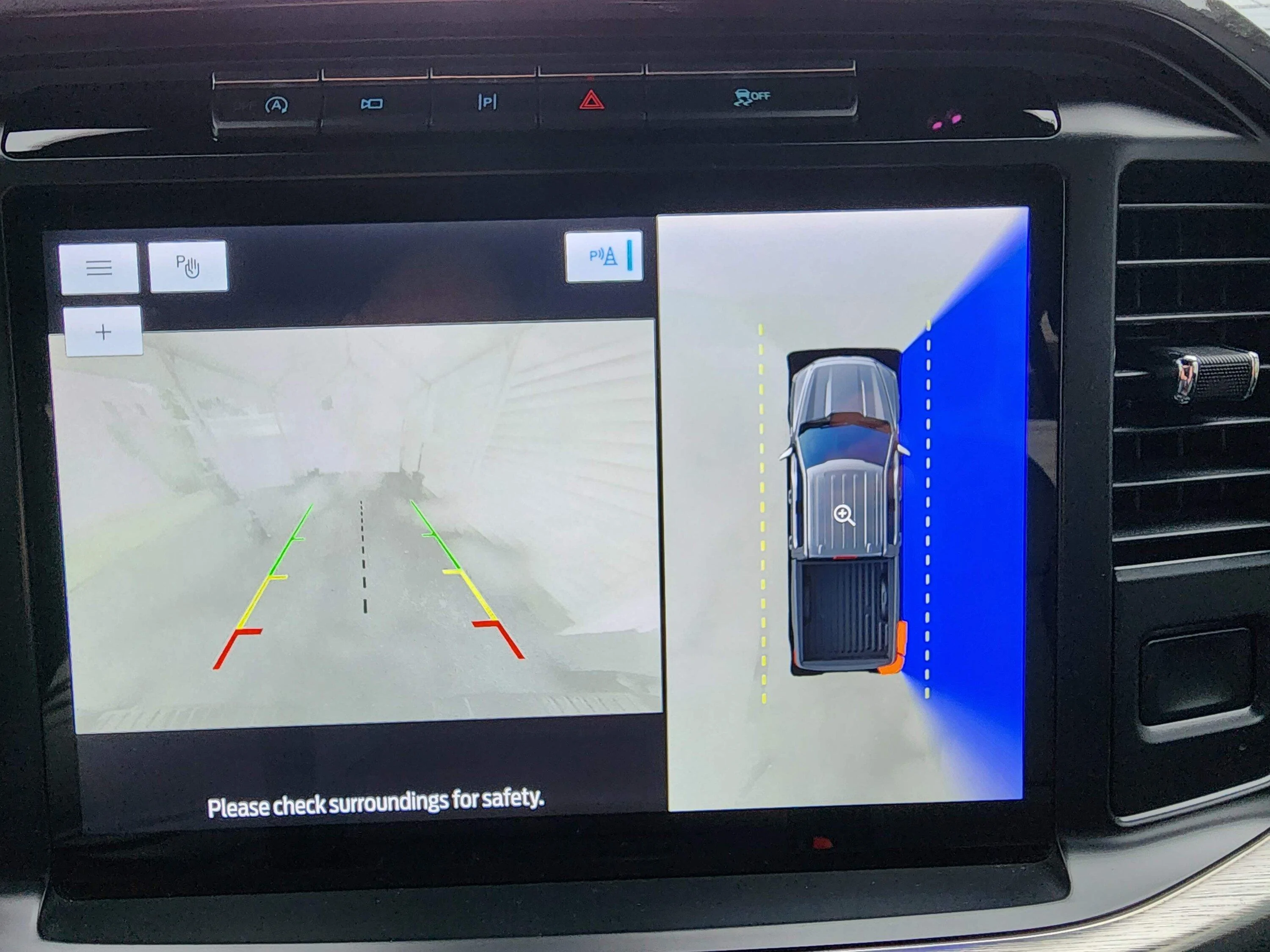

Anyone else have this problem? Sometimes it works fine but the majority of the times it looks like this. Took it to the Dealer a few moths ago and they replaced the camera in the RF mirror. It didn't make a difference. They tell me now its a known problem but Ford doesn't have a fix for it yet. I called another Dealer and they pretty much said the same thing.

Not a problem Ive known about
it may be the coax is bad.
Either in the door where the only junction is. Or it isnt plugged in all the way at the IPMA.
