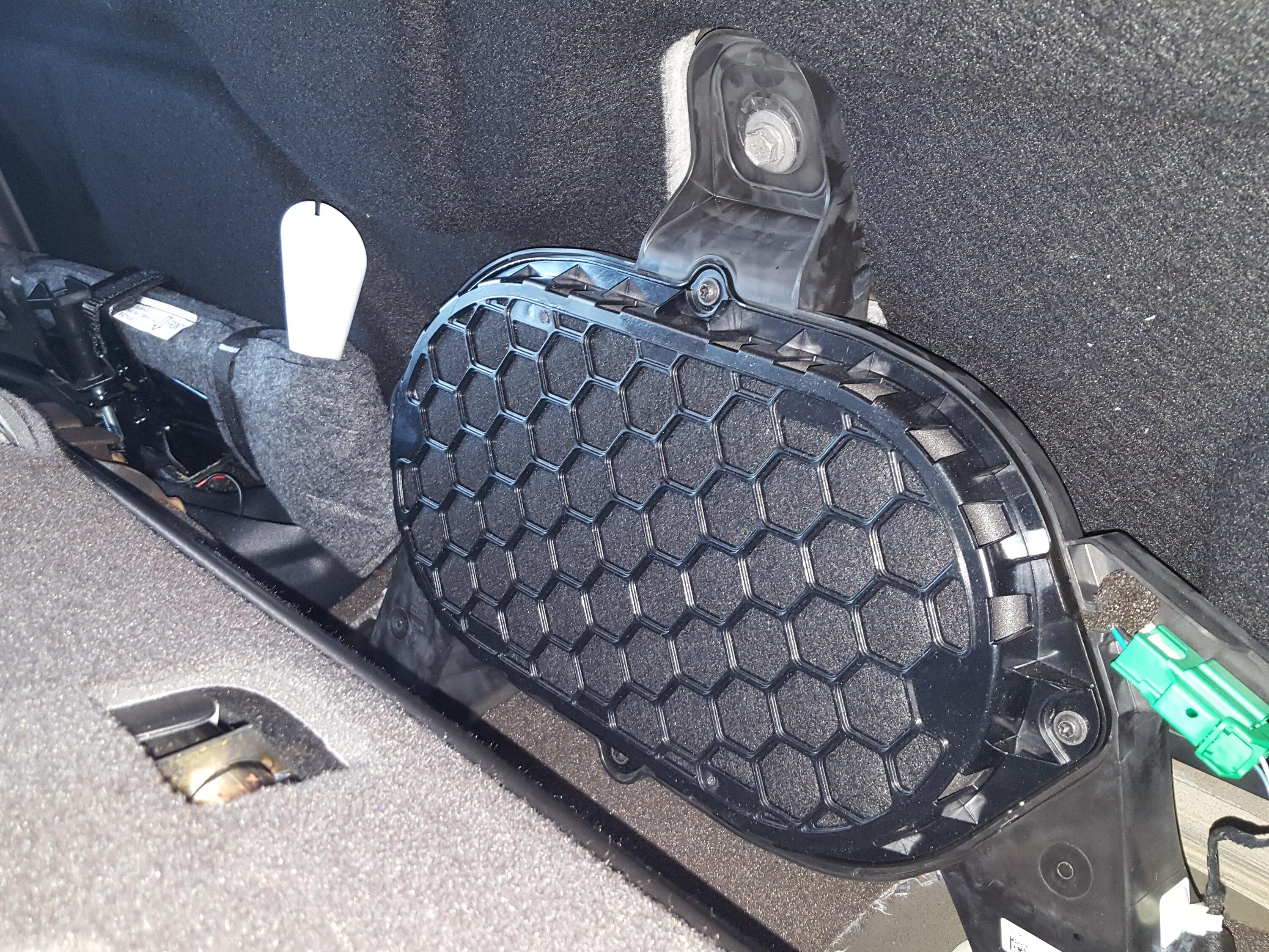

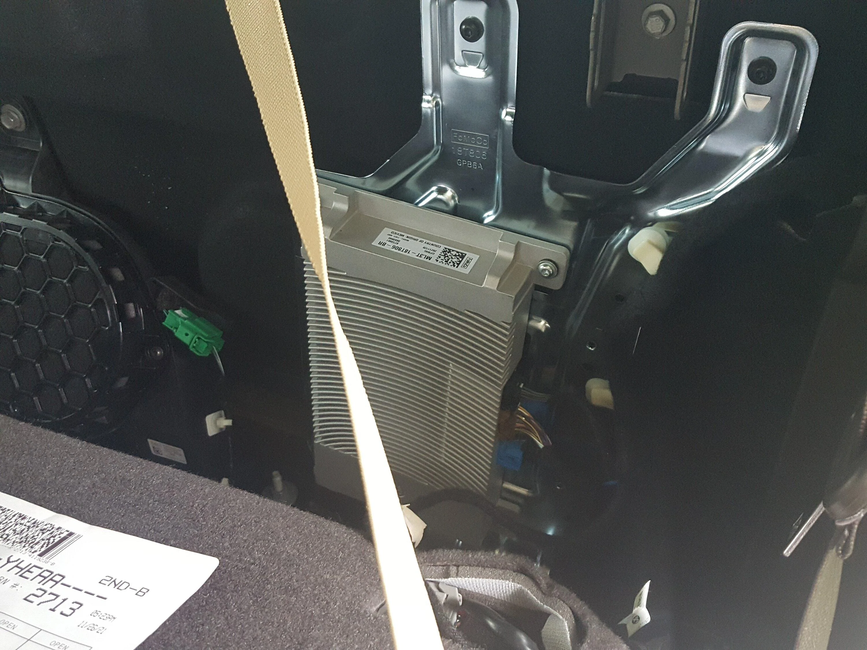

i was back there today, tidying up and the woofer seems pretty small, . and exposed.
i saw the kicker upgrade thing at ford accesseroies but its not comparable with the bo unleashed
my 2013 had it under the seat, and the expedition had it in a compartment in the rear
just me but the thump is pretty deep for my old ears, but i could see how some would like more of it.
think an upgrade is a plug and play thing or would we loose the big amp back there as well??

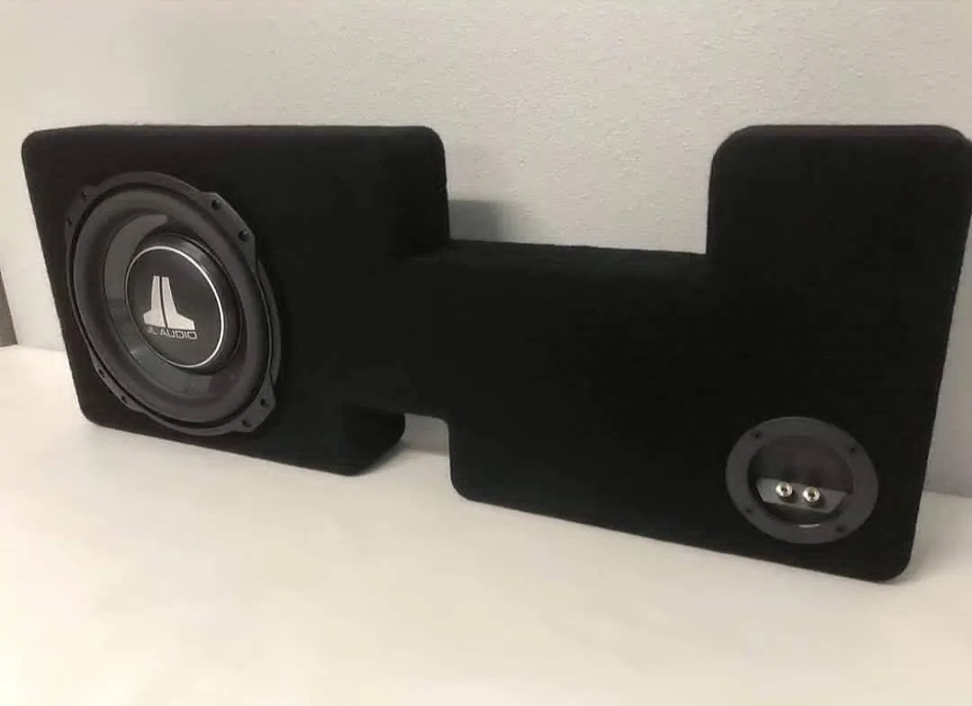

Similar to the reverse steak recipe where you cook it first and seer it last, there's a build thread here on the forum where a fella upgrades the amp(s) to see how much better the oem unleashed speakers will sound with clean headroom.
He does replace the oem sub since that enclosure defies the necessary physics.
I am not willing to give up my underseat storage, so I am considering an MTI behind the seat enclosure.

Is that sub a 6x9?
Is it the speaker quality or not enough power?

its the sub.
actually for me the sound is very good
i am deaf in left ear, if i wear the hearing aid its like being live at center stage.
if i dont wear it i can hear 30% on left ear and still sounds pretty darn good
i was surprised the sub is so "unprotected" on the sides. it does have a grill with some cloth to protect the front face .
i was curious if there is a sub that is plug and play with current wiring from the big silver box amp
