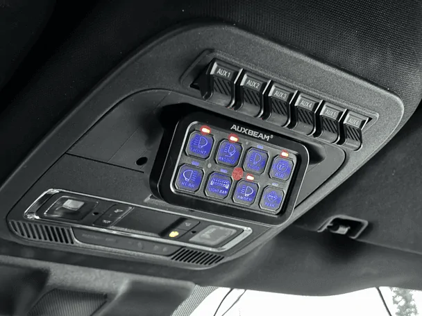

100% completed the install!
I routed the wire through the firewall then ran it all the way across the upper portion on the wiper shroud. It is a absolute pain to get the wire through the firewall, but it can be done. I then mounted the relay module to to top of the fuse box. Then for the controller I tried to but it inside the sunglasses holder without modifying it but it didn’t fit. So I just removed to folding part and mounted it in the crevice left behind!
