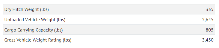

I currently have a Jeep Grand Cherokee Diesel with a 7,200lbs tow rating and 1,050 payload rating. I'm looking to move to a truck and was looking at an F150 Lariat Powerboost with FX4, Max Tow and some other options. I went and looked at it today to get pictures of the door panel stickers. It lists the max payload as 1,340lbs and GVWR as 7,350lbs. We tow a small Jayco 154BH trailer with our Jeep and have weighed a couple of times at CAT scales to ensure we aren't overloaded. We were a bit under the max rating for the trailer, and were limited by the Payload and rear GAWR...with a 1/4 tank of fresh water that is at the front of the trailer and only the 3 of us (myself, wife, kid) in the Jeep we came right the max for the Jeep.
Using Ford's Spec'ing calculations without having access to some of their internal tools I came up with the following and want to make sure this makes sense.
If I calculate tongue weight from trailer max GVWR of 3,450 * 0.15...
Tongue Weight = 517.5lbs
People = 500lbs (This includes padding for the growing kid and dad passing by the 'dad bod' stage)
+ Tongue Weight + Hitch Weight (100lbs)
= 1,117.5lbs total payload, which leaves us 222.5lbs for additional equipment in the bed of the truck, that doesn't seem like much.
If I use the same math with upgrading to a 5000lbs trailer I'm already over the max hitch weight, and 10lbs over the max payload by 10lbs, so basically we wouldn't really be able to upgrade to a much larger trailer?
Since I haven't yet purchased the truck I can't take it to a CAT and weigh. Does a weight distribution hitch reduce the tongue weight? I don't really want to bump up to a F250, but I would like to be able to at least throw bikes and a few other things in the bed of the truck. It seems like I could probably do that with this trailer, but not with anything much bigger. I'm constantly seeing F150s with much bigger trailers than ours. Of course I don't know all the options on their trucks, but I can at least see that they are SuperCrew F150 FX4 and similar. Are that many people just overloading?
