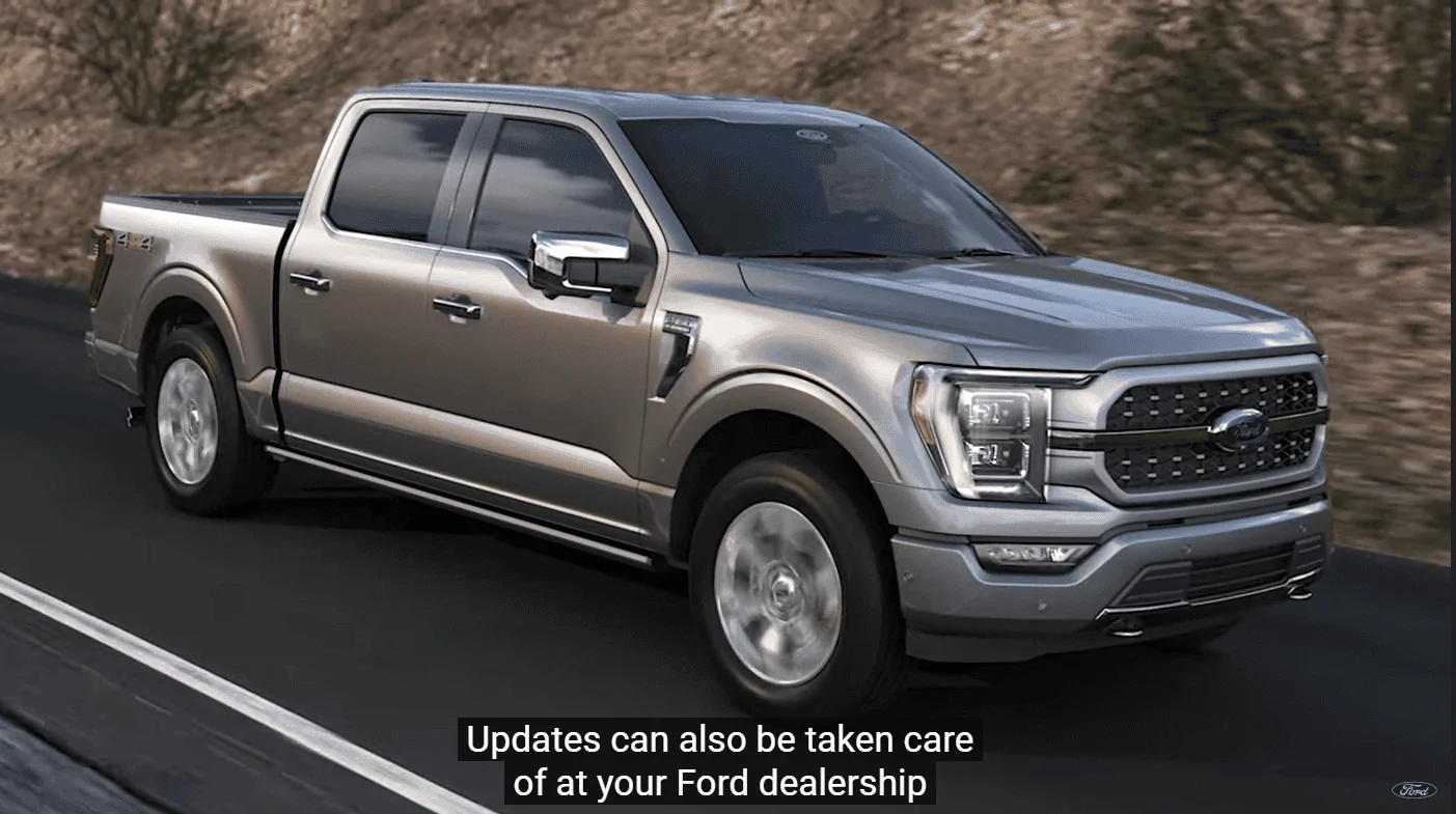

Funny how the "Configure Over-the-air updates" video from Ford says your Ford dealer can take care of them, but lots of stories here attest to the opposite :D
Ford F-150 Apple Carplay / Android Auto expand display 1664928643295

That's a li
Thats a lie lol
