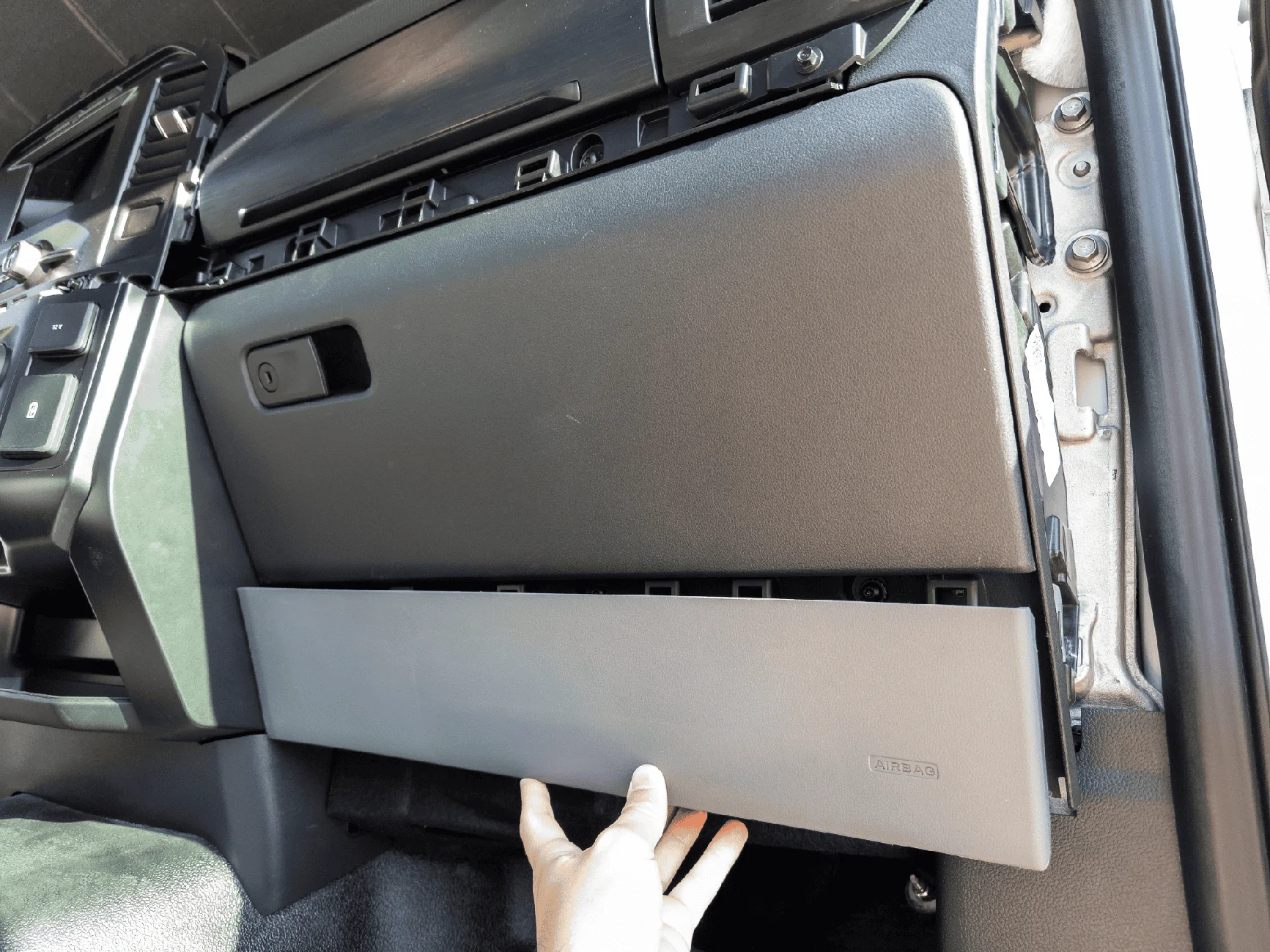

I swapped my entire interior in my 2022 xl regular cab but the only piece I had painted was the passenger knee airbag cover only because it was going to be $400 to buy an entire new airbag. I removed the cover and the glovebox and brought them to the painter who matched it really well. You can see how spot on it is compared to the side dash trim. The glovebox always looked to be a bit different even in my cousin's stx truck so as far as I'm concerned this is spot on. This was painted about 8 months ago.
