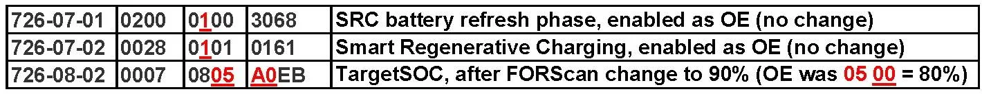

FYI / FWIW, referring to info at that link, here's what I found as OE and the one item (TargetSOC) I changed when I went from the OE H6 to the H8 Everstart on my 2022 3.5EB Lariat. I did not / do not want my SOC target any higher than 90% in order to meet a balance between maintained battery level and long-term battery life (YMMV).
Ford F-150 Anyone know how to disable bms CHARING RELATED PARAMTERS
I made the Target SOC change on the BCM 'Plain English' (aka 'Easy Method') screen in FORScan where I had the choice of 80% (enabled by default) or enabling 90%. Above shows the parameter values changed by that method.
Now 17 months on the H8 with the change shown above, all is great AFAIK (I've never seen any hint of low-battery issues or warnings).

@REFLECTIONxRAGE: I missed editing the actual asbuilt numbers but just change them as per the values listed in the post I referred to earlier. If you change %SOC in easy mode, then go into asbuilt mode and then do a "save all" to make a backup before you change the asbuilt values. Then you can change the 726-07- values and just hit the "write" next to the 726-07- values. Then do a "save all" down the bottom to make sure you have a backup Of your modifications.

No, that easy mode setting changes the asbuilt values. I've set exactly as the referenced post to see what happens: SOC 120%, regen off, refresh on. Will report back after the weekend ?

Ok, after two 8.5 hour drives, setting SOC to 120 as per the referenced post makes the BMS stop charging at 80%. Probably don't want to go higher with an AGM, but the actual value can be set as high as 200% ?‍♂ stays in conventional charging, never saw any refresh mode.
